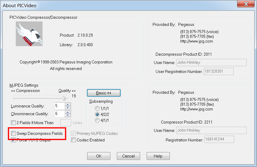

  10. By the way, this field swap problem is most common with MJPEG encoded video. It's easily fixed by using an MJPEG decoder with the field swap option.
    [Attachment 41495 - Click to enlarge]
    This is not the same thing as the "field order" you specify when encoding interlaced video. Interlaced field order is the temporal field order -- which of the two fields is seen first during playback. The field swap issue a spacial problem -- the location of the field on-screen at playback. Though the temporal problem often follows the spacial problem causing the judder you are seeing. For example, the video may be top field first and flagged that way, but the top field is stored as if it is the bottom field, so they play in the wrong order in addition to being in the wrong location.
