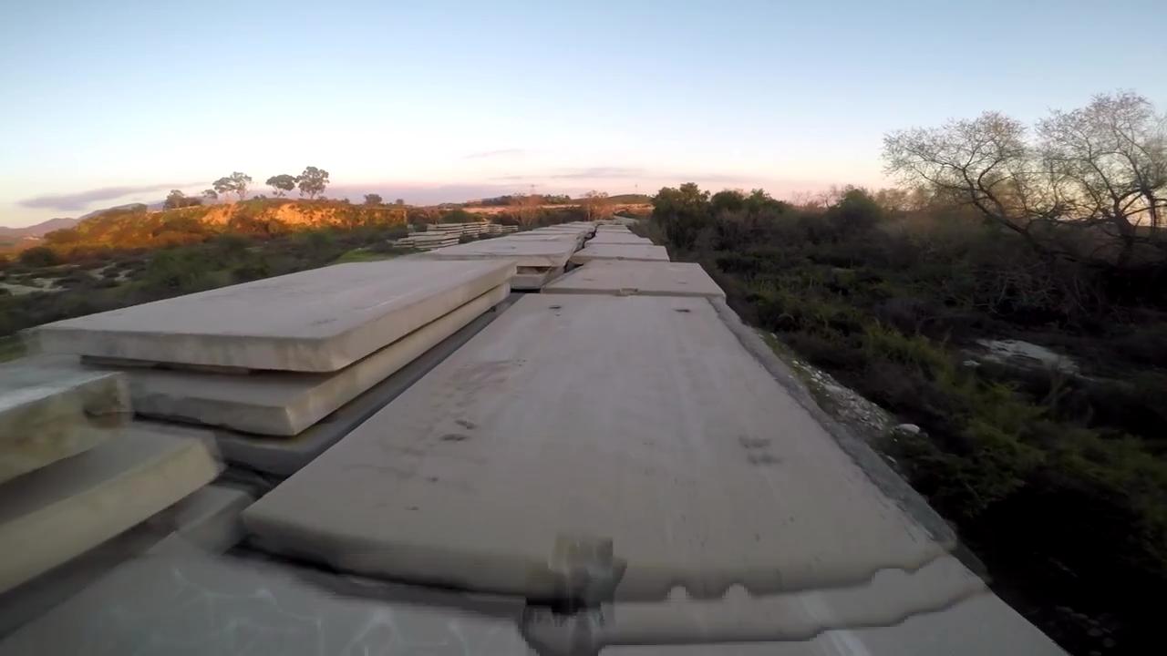

  1. New to the video world. I have a GoPro Hero5 with a gimbal and I'm testing it all out. I shot a video of me testing out the gimbal in 24fps as sunset (low light). After hours of editing footage in FCPX and reviewing the footage on YouTube, I feel like maybe I should've shot in 30fps? I'm learning FPS and how it affects video. I feel like the footage isn't as smooth as it could be. Btw, ISO was set to 400 max. Is this footage choppy? And should I've shot in 30-60fps with a higher ISO because I"m moving fast? Thanks. https://youtu.be/DA2rH0iY_U8
  2. That video was converted from 30 fps to 24 fps by discarding every 5th frame. That creates several jerks per second in addition to the flicker/jerkiness inherent in 24 or 30 fps video. Shoot 60 fps if you want smooth video.

  4. Ah, how did you know that? I just checked and just the first few clips were 24fps so that is what it selected by default. The rest of it is actually 30fps. So... I guess i can't retroactively add frames back? i don't know how it works. Would redoing the project to 30 fps make any difference? And I guess I'd have to re-edit and start all over if I wanted to. Thanks for getting back.

  6. Originally Posted by jaebird82 View Post
    Stepping through the video frame by frame I could see that every 5th frame was missing -- ie, there was a jump in the motion. Also, at normal playback speed you can see the little jerks that creates.
    There are techniques to do so but it's rather difficult. Attached is a segment of your upload where I inserted motion interpolated frames for the missing frames. I used AviSynth.
