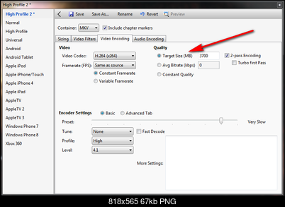

  27. aBigMeanie aedipuss's Avatar
    Oct 2005
    666th portal
    vidcoder has a file size setting. tell it what size you want and it will attempt to do it.

    And no matter which program or setting you use you will change quality - haven't arrived at the "something for nothing" stage in encoding My suggestion is get a media player that handles all file types and formats and attach it to the TV.
  29. Originally Posted by aedipuss View Post
    The Video BR is down to 9MB ABR from 20MB.
