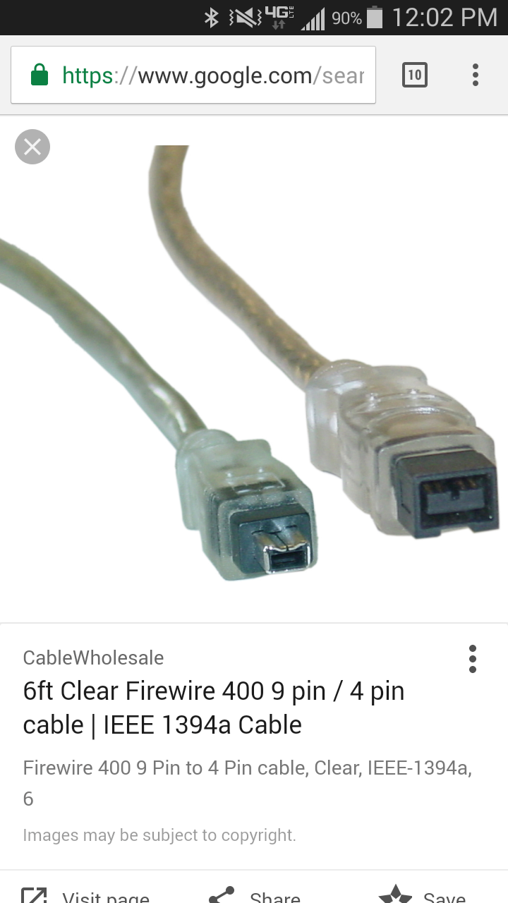

    I was under the impression that FW 800 was backwards compatible with FW 400 when it comes to the physical connections. I'm planning on using a cable like this to bridge from the FW800 port on the adapter to my camcorder:
    [Attachment 40972 - Click to enlarge]

  4. It's backwards compatible for things like hard drives. Camera control has always required that extra step. On a Mac, it's the ONLY combination that works.
