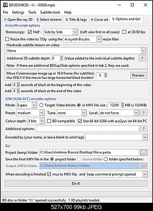

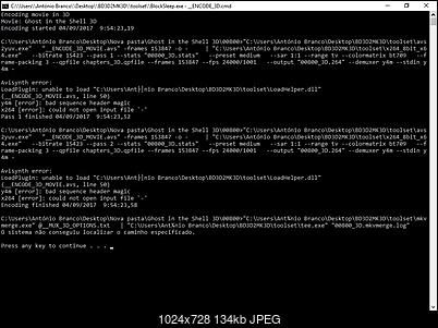

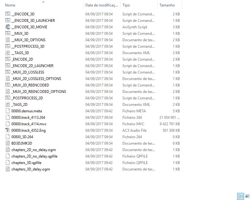

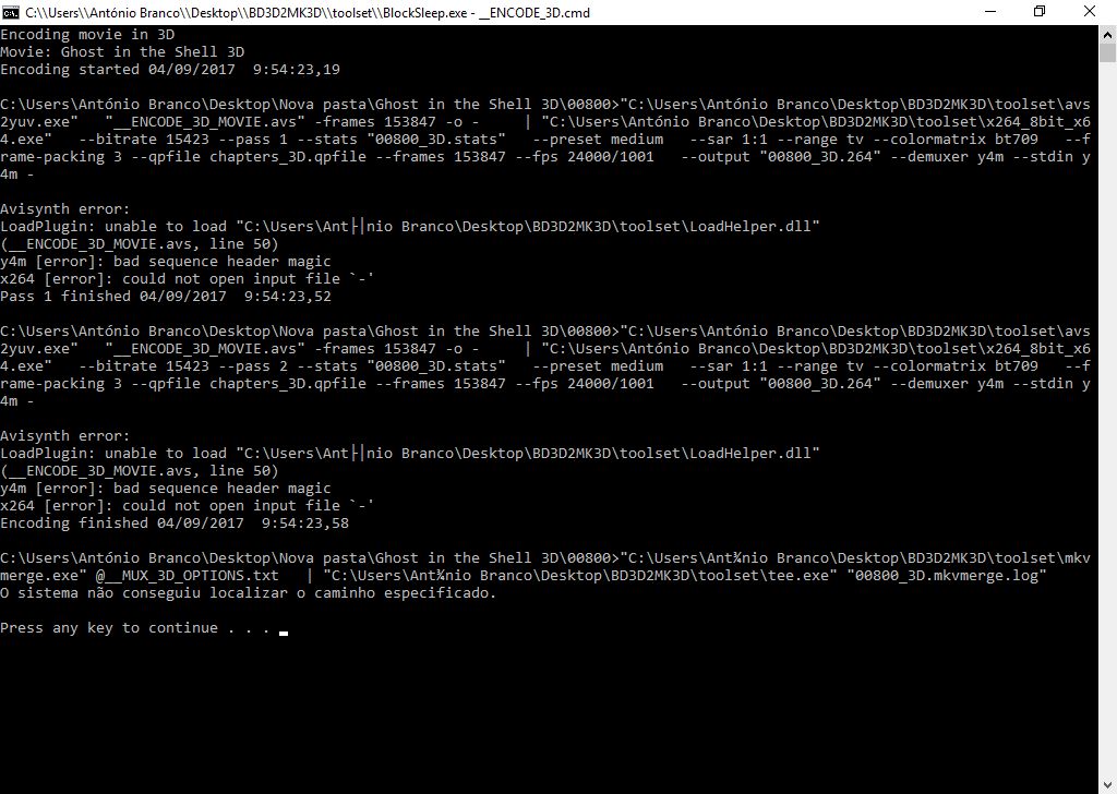

    Dear Sir,
    Thank you to your email concerning my problem with the correct working with your BD3D2MK3D software.
    During the process I have a Avisynth error, as you can see on the “BD3D2MK3D 3” image.
    I’m trying to understand what is happens on my PC, because before it was properly working, but not now, and I don’t understand why?
    I don’t find a solution.

  6. Thanks for the information.
    I wonder if the problem could be caused by the accented character in your name. Windows has 3 different ways to encode the accented characters (yes, 3!), and it is often a pain to mix regular programs (like BD3D2MK3D itself) and CLI programs running in a command prompt window (like avs2yuv, x264 or mkvtoolnix), because they don't use the same character encoding scheme, and they cannot pass the arguments to each other correctly.
    Can you confirm that you did not save the projects in a folder with the same path name under your old version of Windows (or at least, confirm that the path did not contain accented characters)?
    Can you also try to move the project folder elsewhere, in a path without accented characters, and launch __ENCODE_3D_LAUNCHER.cmd from there? If that doesn't work, can you move the BD3D2MK3D's installation folder elsewhere (again in a path without accented characters) and generate a new project from scratch? You may also have to change the two paths in the "Go!" frame of the last tab of BD3D2MK3D. Please tell me if one of these suggestions has solved the problem.
    In the meantime, I will do some tests here. But anyway, I suggest to change your user name and use a name without accented characters, such as Antonio instead of António. You may have to create a new user for Windows, but I strongly recommend doing it, as otherwise other programs may also fail. That may be the case of AVCHDCoder, I don't know.

    Aug 2017
    Portugal
    Thanks very much for your precious help.
    Finally my problems as finished.
    The problem it was the accented character on my User PC Name.
    Now, both software are working correctly.
    Thank you again.
  8. Thanks to you too! I will try to modify BD3D2MK3D so that that problem will not occur again, even when the path names contain accented characters, but I'm not sure it's possible. AFAIK, there are no problems under Windows 7 and 8, and I wonder what has changed in Windows 10. But thanks to your help, I know where to look...
    r0lZ - PgcEdit homepage Hosted by VideoHelp (Thanks Baldrick)
    - BD3D2MK3D A tool to convert 3D BD to 3D SBS/T&B/FS MKV
  9. Done. I've found a workaround for the Avisynth foreign characters in path bug. BD3D2MK3D v1.2 (to be released soon) should work correctly even when path to the toolset folder contains non-ASCII characters. However, I cannot certify that the new version will work with all forks of Avisynth. At least, it works with the latest official Avisynth version (v2.60 for x86).
