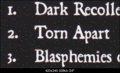

  2. Did you want just the text from track 2 to "glow" ?
    Something like this ? (This is cropped to the region of interest, and I edited out the circle)
    (The gif preview in some browsers is messed up on this site , you might have to click on it to open in new tab)

    You should be able to do it in aviutl (but it's a bit quirky, not that intuitive at first with some learning curve)
    Or I can do it for you quickly if you tell me what: format and compression, resolution, framerate, rate of glow / flashing, duration, color, any other changes/requests ?

    I actually meant the whole oval I originally circled, but your looks so much better!I didn't even think about that.

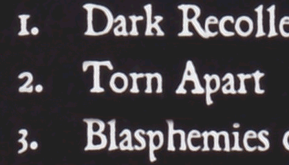

  4. I actually used after effects for that, but you can do it in aviutl.
    I'll upload the aviutl project file and assets. For the asset, I used a cropped version (crop.png) instead of the large image, but the concept is the same
    1) Import 2 instance of the image. Recall that layers with higher numbers are "on top" (reverse to something like photoshop or image editors). So Layer 1's instance is just the plain version, no filters. Think of it as the background image
    2) Layer 2's instance has mask and glow effect applied. The mask is just a rectangle/square, and you adjust the parameters to the region of interest. You can disable Layer 1's visibility temporarily by clicking the layer 1 button to visualize what is going on better (click it again to reactivate). Another method is to use a nested scene as the mask, this way you can have more complex, animated masks. But a rectangle is all you need here. Think of it as limiting the effect of the glow. Instead of everything glowing, you only want the area of interest to glow
    3) Set the glow parameters like color, blur , etc... and keyframe the strength. The first thing you do before setting keyframes is set the interpolation type (e.g. push the strength button and set it to something other than "no movement"). Rectilinear is just linear. There other interpolation curves you can use. Then you advance right click and set midpoints or the shortcut key is "p". It's a bit tough if you're new to aviutl's keyframing (they are called "midpoints" in aviutl) system, but there is a tutorial thread with videos where racer-x goes over the basics
