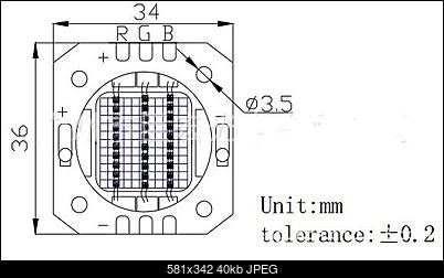

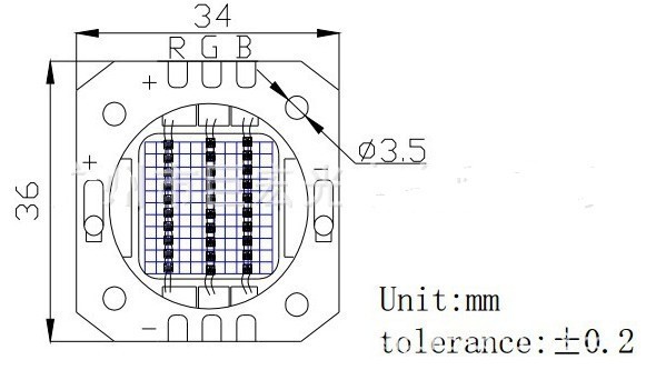

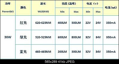

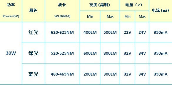

I tried to do some research but I'm working blind. I found China made 30W RGB COB led but I have no idea if that is the type used in projectors. The max lumen specs of the green bank (Chinese desc. but I think "Green" based on sequence pic 2) curiously match the max specs of the AAXA M4 projector which is rated at 800 lumen.
Since the company won't help obviously I'm left with guessing as to the design, components and what the problem could be. At first I thought the LED itself had burned out but the way the colours went out the problem might be the driver board. If i"m right, based on the chart the voltage would have to be maxed out to achieve the 800 lumen rating of a 35 watt RGB COB led chip. As I said the PJ still works but its all red. It's natural that the PJ would also be dimmer since in the chart RED is the colour that lights with the least voltage of 22-24 volts The higher voltage green and blue led won't light. If I could find a reliable electronic repair shop in Ontario Canada they might be able to fix the board. I haven't opened it up since I don't want to damage anything. I'd sooner have someone who knows what they are doing be the first to open it.
