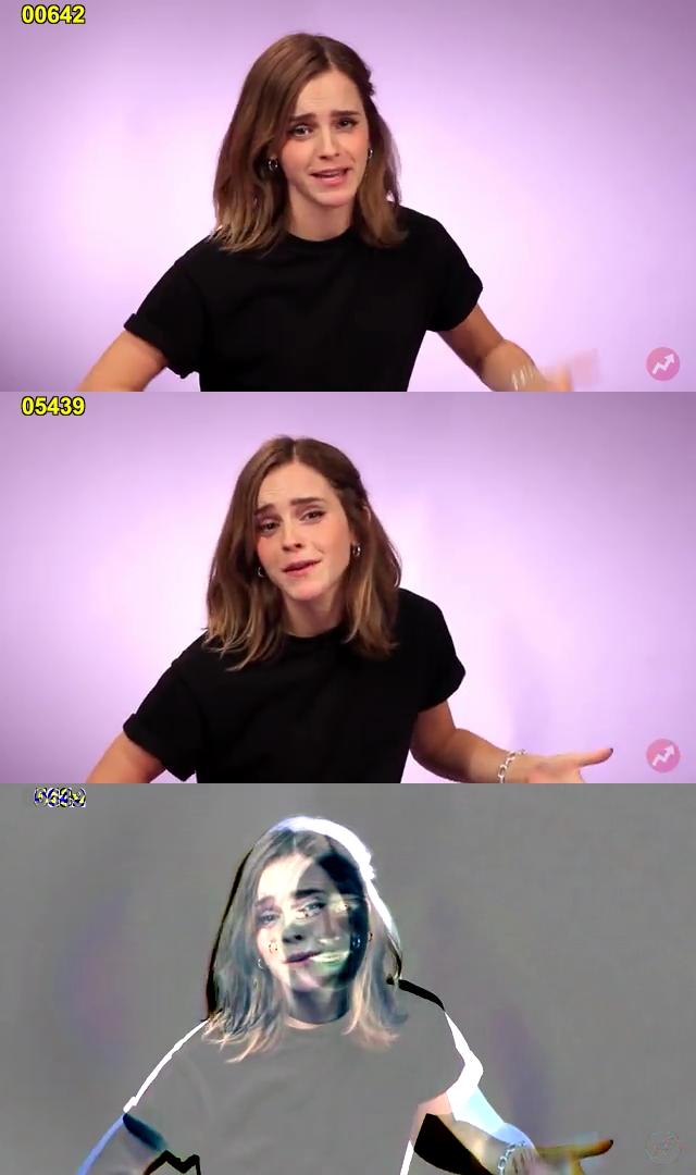

A simpler method in AviSynth would be to just subtract the frame you want from the rest of the video, then scan through the video yourself to find a near match.
That stacks the still frame (taken from the video), the original video, and the difference between the original and the still -- at each frame of the video. Here's a sample frame from the resulting video:Code:LSmashVideoSource("video.mp4") still = Trim(642,642) # the number of the frame you want to match return(StackVertical(still, last, Subtract(last,still)))
[Attachment 40967 - Click to enlarge]
And attached is a short clip around the cut (frames 642 through 5438 were removed) with a few frames of motion interpolation between them. -
