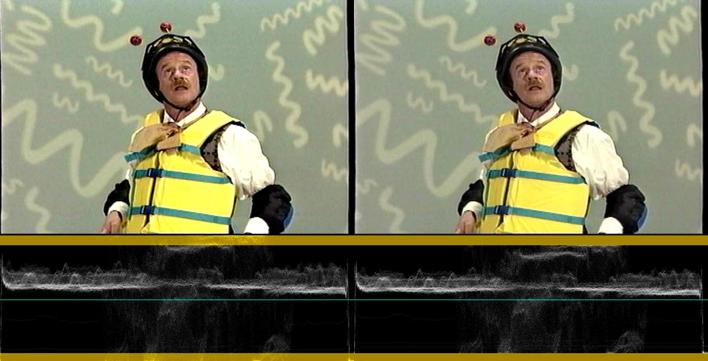

    Here's an example of a full range capture (MJPEG in AVI). On the left is the original cap, on the right is the result of fixing the levels with ColorYUV(levels="PC->TV"):
    [Attachment 41190 - Click to enlarge]
    After the fix you can see more detail in the bright vest and shirt, and the dark elbow pads and helmet. In theory you could encode the video as full range without levels adjustments, flag it as such, then hope that the player recognizes the flag and obeys it. But in my experience few players will do that.
