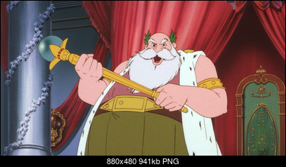

    I am trying to encode a Blu-Ray of mine and I'm having a color problem. This is obviously a rec601/rec709 issue but I cant get it fixed.
    When I open the M2TS in any media player on any computer I have, the video and colors look like this. This is also how the DVD's colors look when I play it back in any media player on any computer of mine.
    The problem I'm having is every time I run it through AVISynth the colors end up looking like this. (Notice the reds are really dark looking)

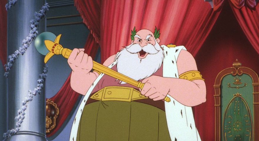

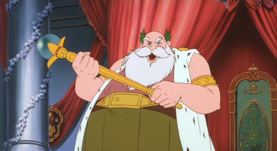

    Screenshot is from M2TS and the finished encode, top is M2TS bottom is encode. Yes their being played with the same program and screenshots are being taken the same way. I tried 3 different media players and their all doing the same thing and on other computers.

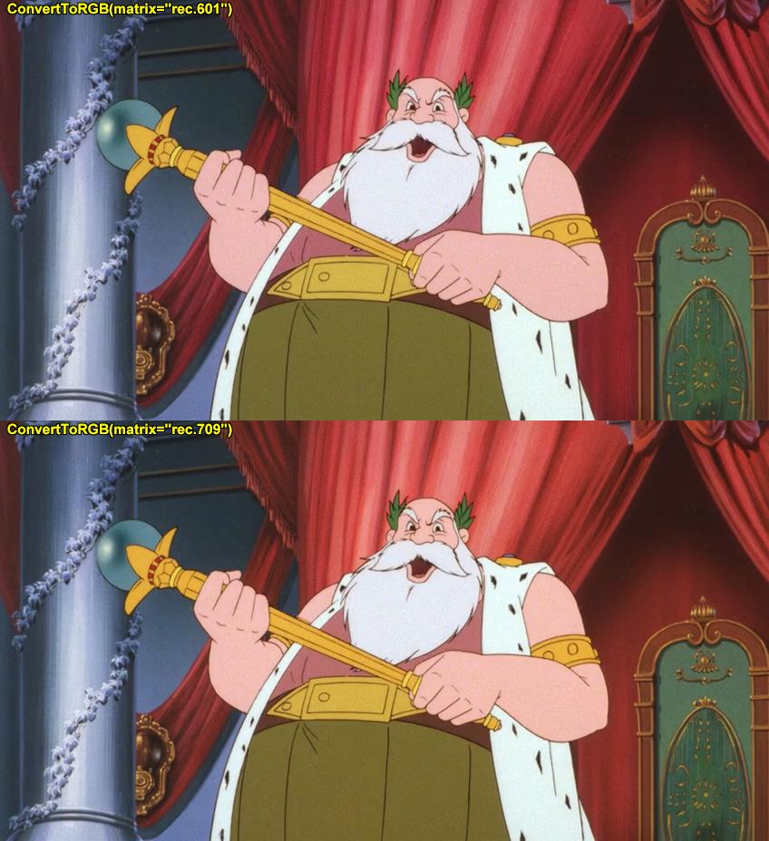

  11. Just noticed your encoded sample:
    LWLibavVideoSource("00000 480p colorprim 709 ConvertToYV12.mp4")
    StackVertical(ConvertToRGB(matrix="rec601").Subtitle("ConvertToRGB(matrix=''rec.601'')"), ConvertToRGB(matrix="rec709").Subtitle("ConvertToRGB(matrix=''rec.709'')"))
    [Attachment 40948 - Click to enlarge]
    Your player is ignoring the rec.709 flag and using rec.601. Maybe because you've downscaled to SD. Sometimes players use rec.601 for SD and rec.709 for HD.
