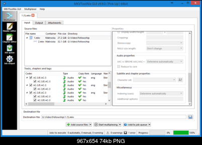

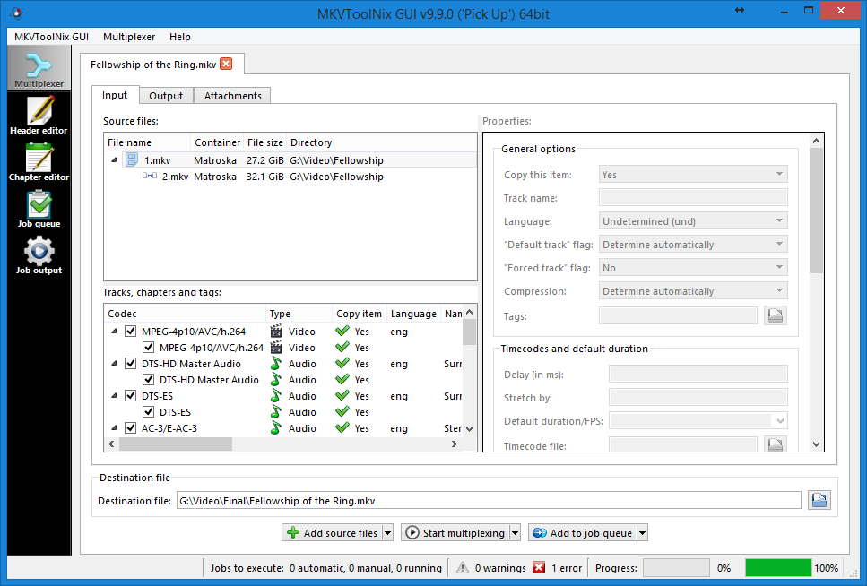

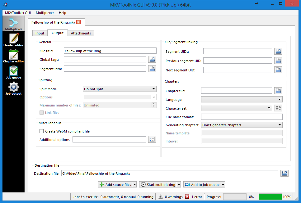

  2. I never had that problem. Are you using the latest version? Can you make a screenshot of the windows with all files, tracks and the error message visible? Copy error message and command-line here (Multiplexer->Show Command line->Copy to clipboard).

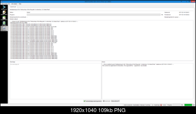

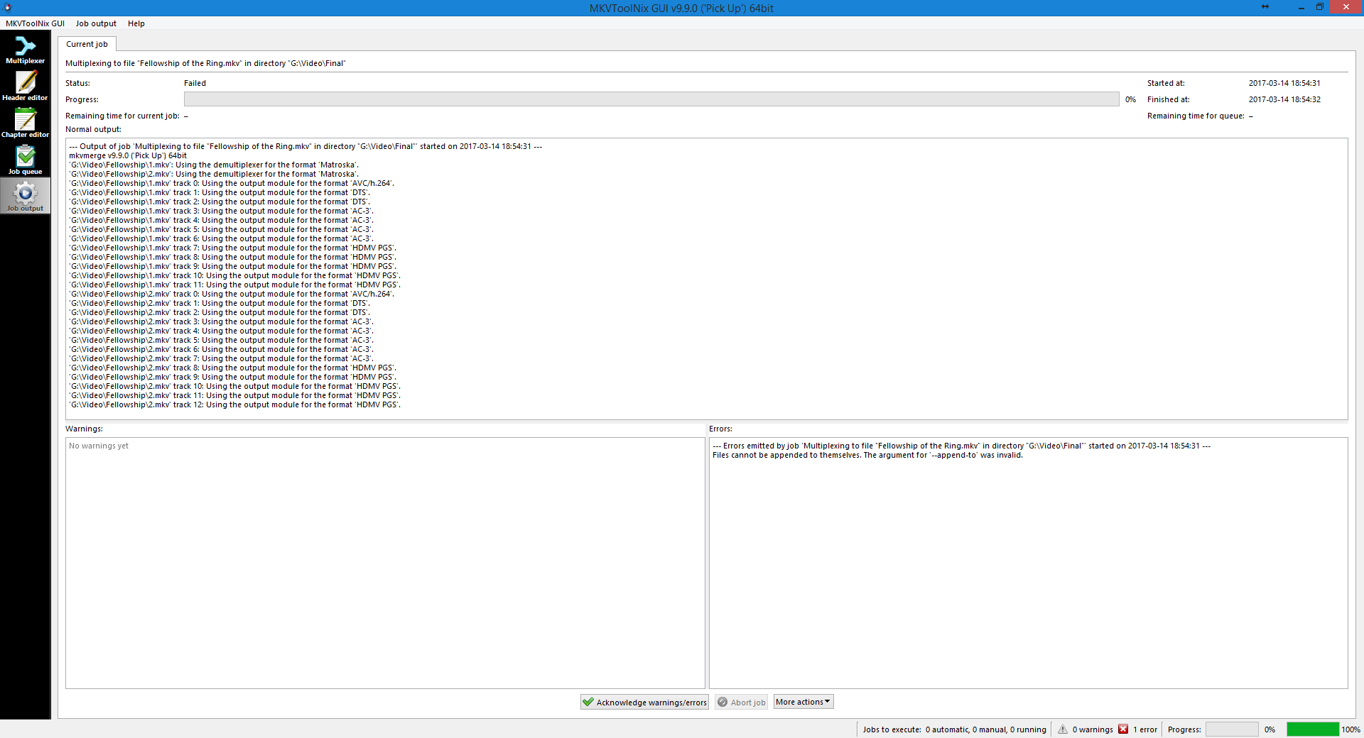

  3. I am using MKVToolNix Gui v9.9.0 (`Pick Up`) 64bit.
    I deleted the ini file, along with the cache and jobqueue.
    Enclosed are the screenshots and logs as requested.

    LOG:
    "C:/Program Files/MKVToolNix\mkvmerge.exe" --ui-language en --output ^"G:\Video\Final\Fellowship of the Ring ^(Extended^).mkv^" --language 0:eng --language 1:eng --track-name ^"1:Surround 6.1^" --default-track 1:yes --language 2:eng --track-name ^"2:Surround 5.1^" --language 3:eng --track-name 3:Stereo --language 4:eng --track-name 4:Stereo --language 5:eng --track-name 5:Stereo --language 6:eng --track-name 6:Stereo --language 7:eng --language 8:eng --language 9:eng --language 10:eng --language 11:eng ^"^(^" ^"G:\Video\Fellowship\1.mkv^" ^"^)^" + ^"^(^" ^"G:\Video\Fellowship\2.mkv^" ^"^)^" --title ^"Fellowship of the Ring^" --track-order 0:0,0:1,0:2,0:3,0:4,0:5,0:6,0:7,0:8,0:9,0:10,0:11 --append-to 1:0:0:0,1:1:0:1,1:2:0:2,1:3:0:3,1:4:0:4,1:5:0:5,1: 6:0:6,1:7:1:6,1:8:0:7,1:9:0:8,1:10:0:9,1:11:0:10,1 :12:0:11
    If it turns out to be a bug, I will report it to the author. Just want to make sure Im not over looking anything
  4. The first file has 12 outputs but the second one has 13. I assume it has something to do with that. Will take a closer look tomorrow but if you remove the extra track from the second file it might be fixed. Could still count as a bug though if the GUI creates this non-working command.
    /edit:
    Yes, one append-to is 1:7:1:6 which would be appending to itself.

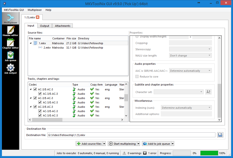

  5. Ok. Looking at what it going to be appended I see this.
    It looks like part two has an extra audio track for some reason. Is this what is causing the issue?
    I will redo the editing to the 2nd part of the movie and see if that extra track appears again.
    Thanks for the suggestion.
    EDIT:
    I see what happened. There is an extra audio track in section 2 because I missed it when ripping it the first time. The language is "pro" while the rest is "eng".
    So essentially, everything can be ammended because there is something to ammend to. However, because of this extra audio track, there is nothing to ammend it to, so its ammending to itself.
    Ill fix this error and am sure it will be fine after that.
