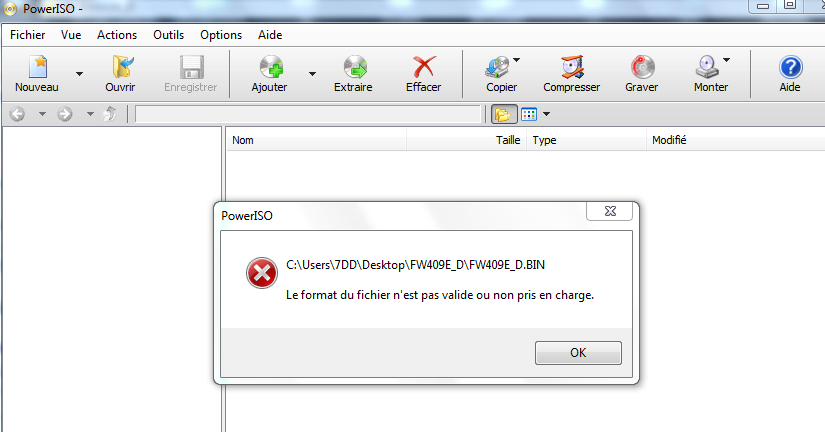

    I need new firmware acard ARS-2050
    Aug 2006
  3. I Download firmware but there is a problem in the file + All the files in the site acard.com does not work
    Image Attached Images

  6. The problem of the files in the site are not corrupt act cannot burn the file on CD
    Is it possible to obtain the firmware update file from another site

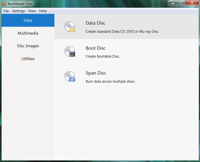

  8. If you don't know how to burn as data 1)open BurnAware and select DATA disc
    2)drag and drop bin file
    3)click burn
    [Attachment 40940 - Click to enlarge]
