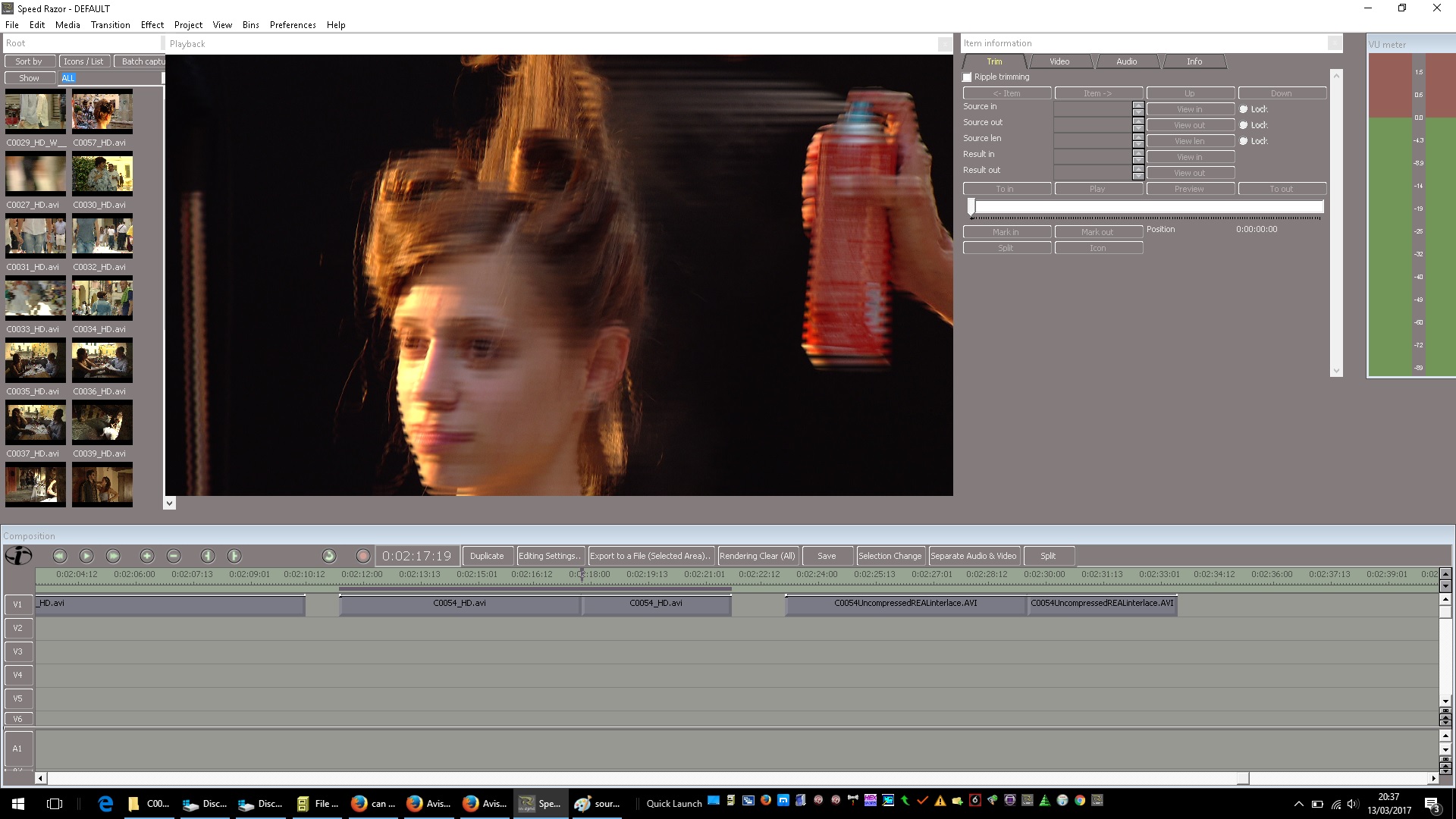

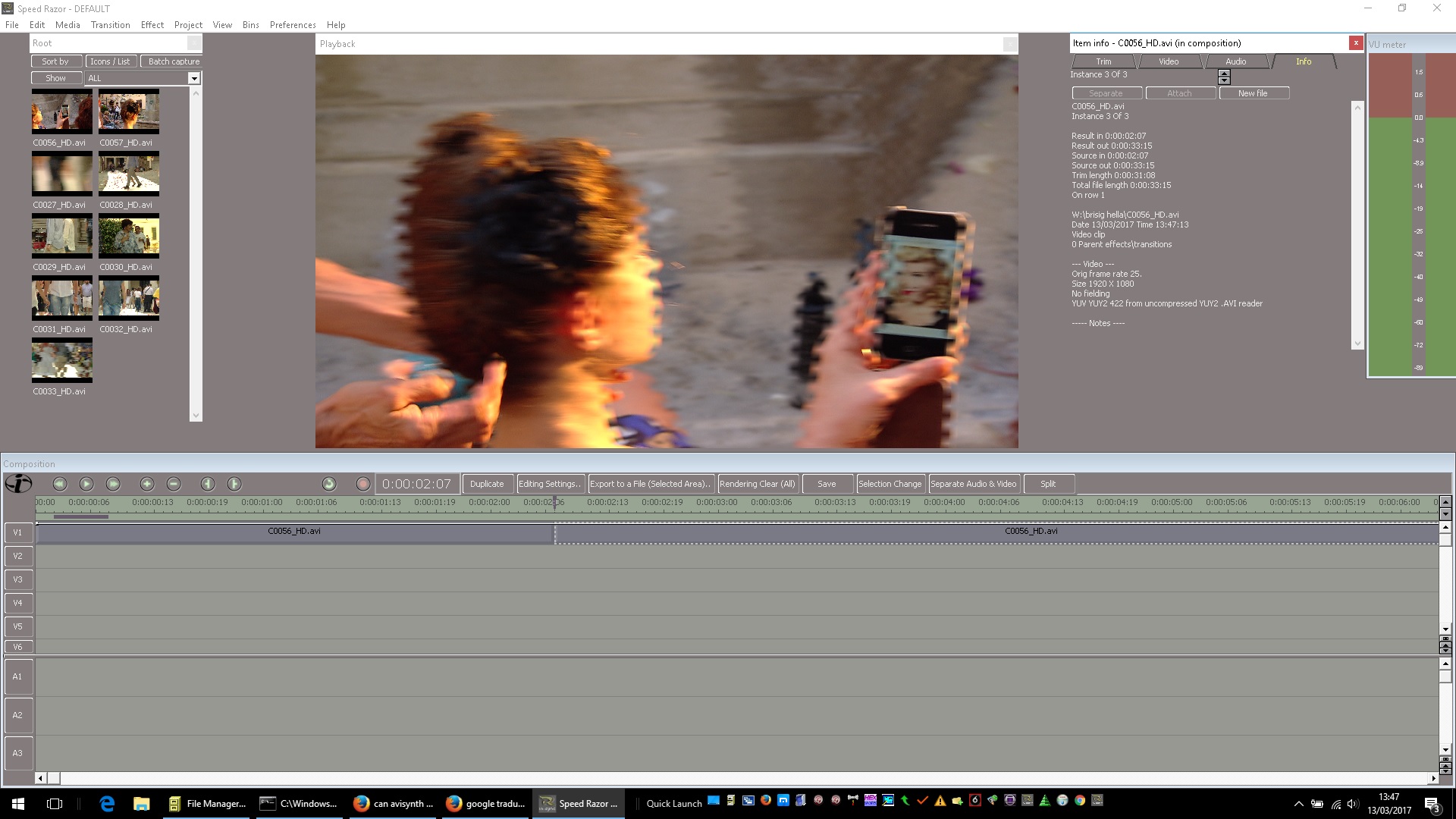

 AVFS works well but don't ouput flagged interlaced (even if content can be treated as interlace ("source is fielded"), so that my NLE recognize all as "progressive" ("No fielding") and don't apply the internal deinterlacer so that result is this: so that result is this:
 [Attachment 40921 - Click to enlarge]
 the "disturb" is present expecially on images in movements. The clip C0056_HD.AVI is a fake avi file, correctly imported by the NLE (playback is absolutely fine) but recognized as Progressive even if at interlace content.

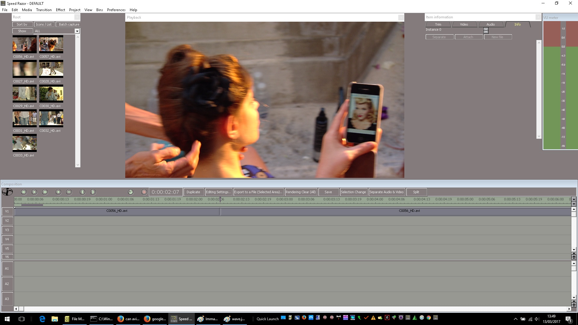

 so that image have that I called "visual deinterlace":Code:LoadPlugin("v:\automazioneclip\avisynth\plugins\LSMASHSource.dll") LWLibavVideoSource("W:\C0056.MXF") bob().SelectEven()
 [Attachment 40922 - Click to enlarge]
 but, this is not the correct way: because to render effects/transition the NLW went have a wrong input... this however is not a big problem because, only have to remove the bob().SelectEven() line BEFORE the export to file process.

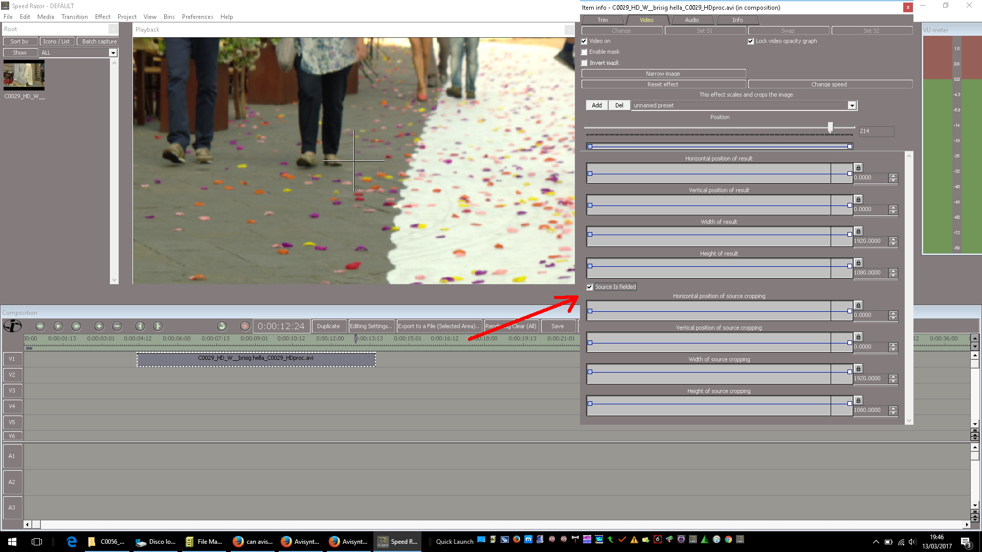

 theorically yes but in practice don't have effects on the internal visual deinterlacer it have effects only in the rendering segments. For each .avi YUY2 uncompressed taked by AVFS, the razor "see" this files as "no fielding"=progressive and don't appy the internal deinterlacer. By default the razor have checked the flag "source is fielded" because the Project Editing Settings is set as "1920x1080@25fps even field parity" = interlaced. If I uncheck the flags the clip need to be rendered also for the playback ... impossibile working in this mode, OR I can change the project editing settings to progressive instead of interlace. But too mess, the problem is that a interlace clip exposed by the AVFS is not signed as "flagged interlace" so the result is this: it have effects only in the rendering segments. For each .avi YUY2 uncompressed taked by AVFS, the razor "see" this files as "no fielding"=progressive and don't appy the internal deinterlacer. By default the razor have checked the flag "source is fielded" because the Project Editing Settings is set as "1920x1080@25fps even field parity" = interlaced. If I uncheck the flags the clip need to be rendered also for the playback ... impossibile working in this mode, OR I can change the project editing settings to progressive instead of interlace. But too mess, the problem is that a interlace clip exposed by the AVFS is not signed as "flagged interlace" so the result is this:

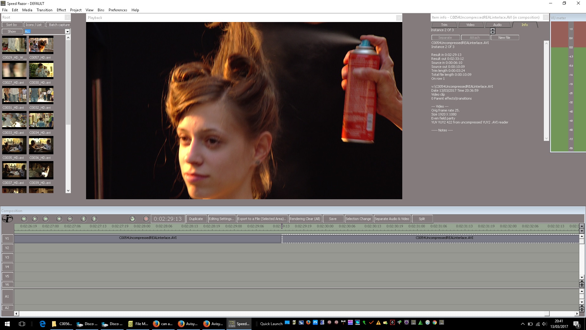

 Another proof: I take to the Razor a clip that is correctly flagged as interlaced also from mediainfo. Its a real encoded uncompressed YUY2 .avi file, not an AVFS file, but a difference of the AVFS is flagged interlaced and recognized by the NLE as "Even Field Parity"= interlaced. In this case the "visual deinterlace" is correctly apply by the razor:
 [Attachment 40927 - Click to enlarge]
 But unfortunatly using AVFS this, at the moment, is not possible. And is not possibile edit with HD uncompressed video file
