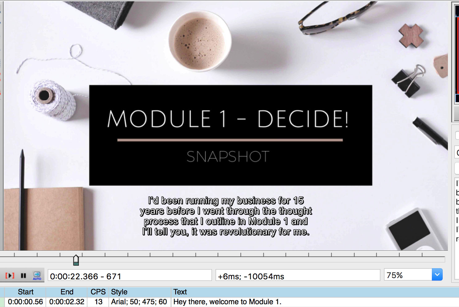

    I just opened the file in Aegisub and everything looks great. Re-saved it as .ass but it isn't being recognized by the forum or by Handbrake, but I had no problem opening it in mkvtoolnik.

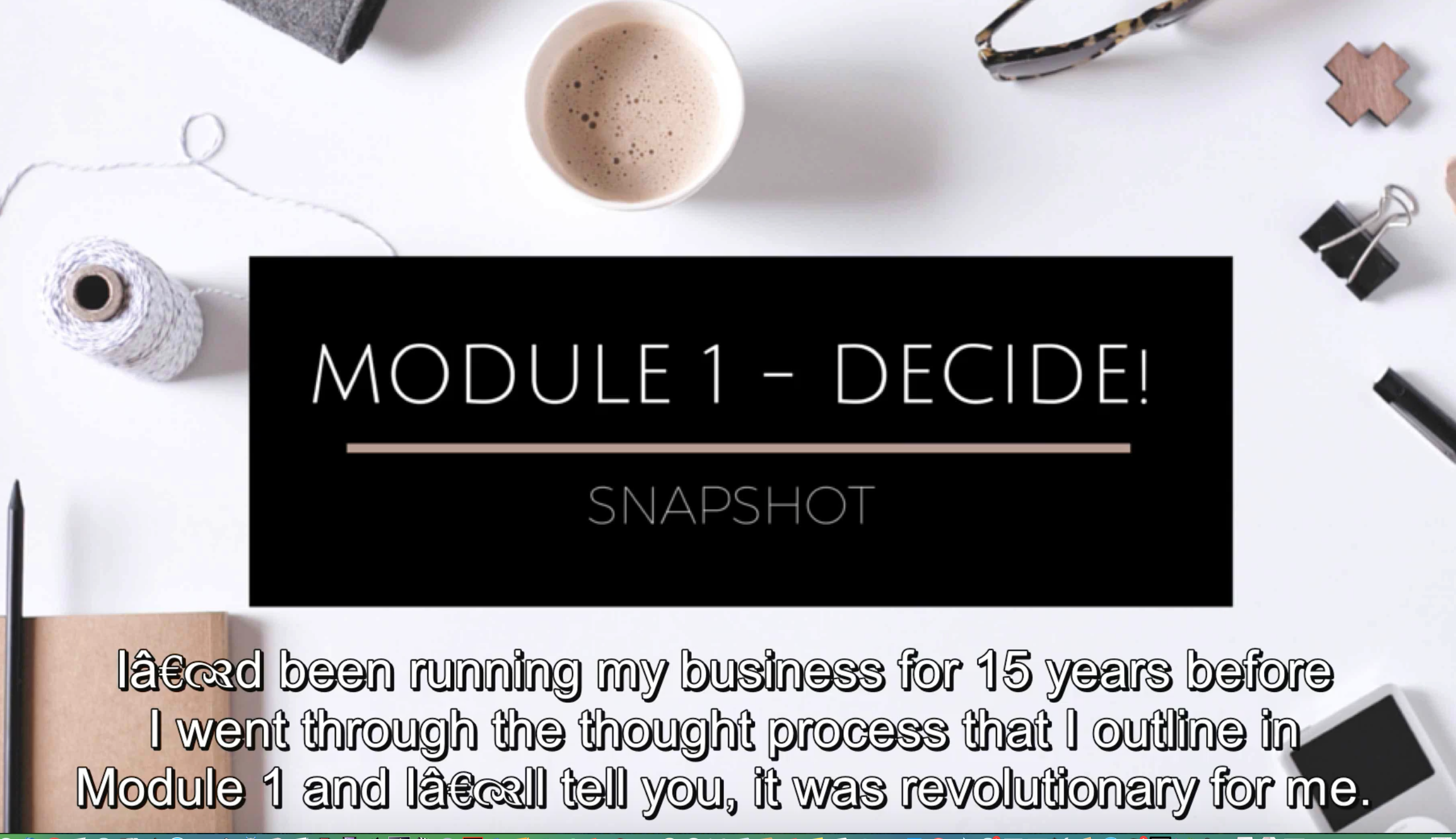

    I had funny characters this morning when I used HandBrake to Hard Code the subtitles using the .srt file I saved from Aegisub, plus the first line of the subtitles is being skipped by the video. The font was just Arial, so I wouldn't think it would be a problem. Anyway, that's why I'd like to use the .ass file if possible, just can't figure out how to do it.

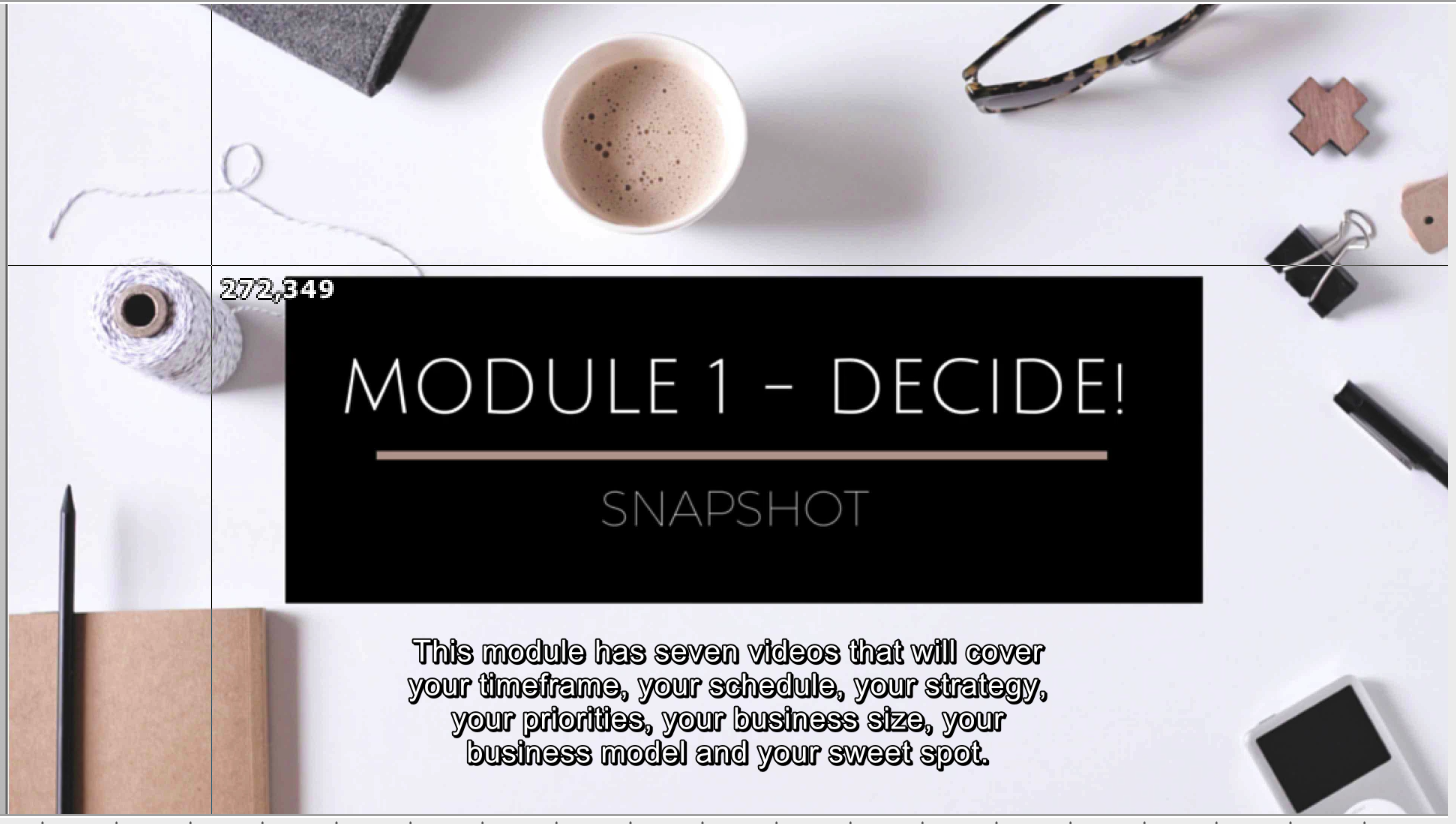

    I attached .png files of what the MP4 looks like after hardcoding using the .srt file - you can see the funny font and also the first line of the sub titles that doesn't show up. the font is also twice as big as I what I had set it at.
    Any suggestions?

  17. I don't have the problem with the apostroph here on Windows 7 + HandBrake 1.0.3. Can you try to do it again with the file I attached? Otherwise try a different font or try replacing ’ by '. I don't know if it's a problem with apple or with HandBrake.
    Alternative would be to try a different software like ffmpeg but usage is more complicated than HandBrake.
