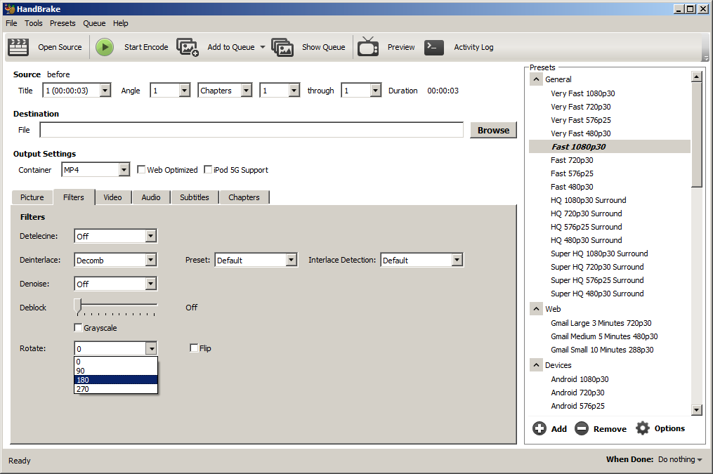

  3. Are you using the CLI or the GUI? In the GUI you can simply select the rotation filter. The documentation says for CLI rotation you'd also use 0, 90, 180 or 270 as value but if jagabo says "4" also works...
    Was attempting the CLI as well as the "Extra options", with same results. I've completely missed the filter option - that works! Thanks!
