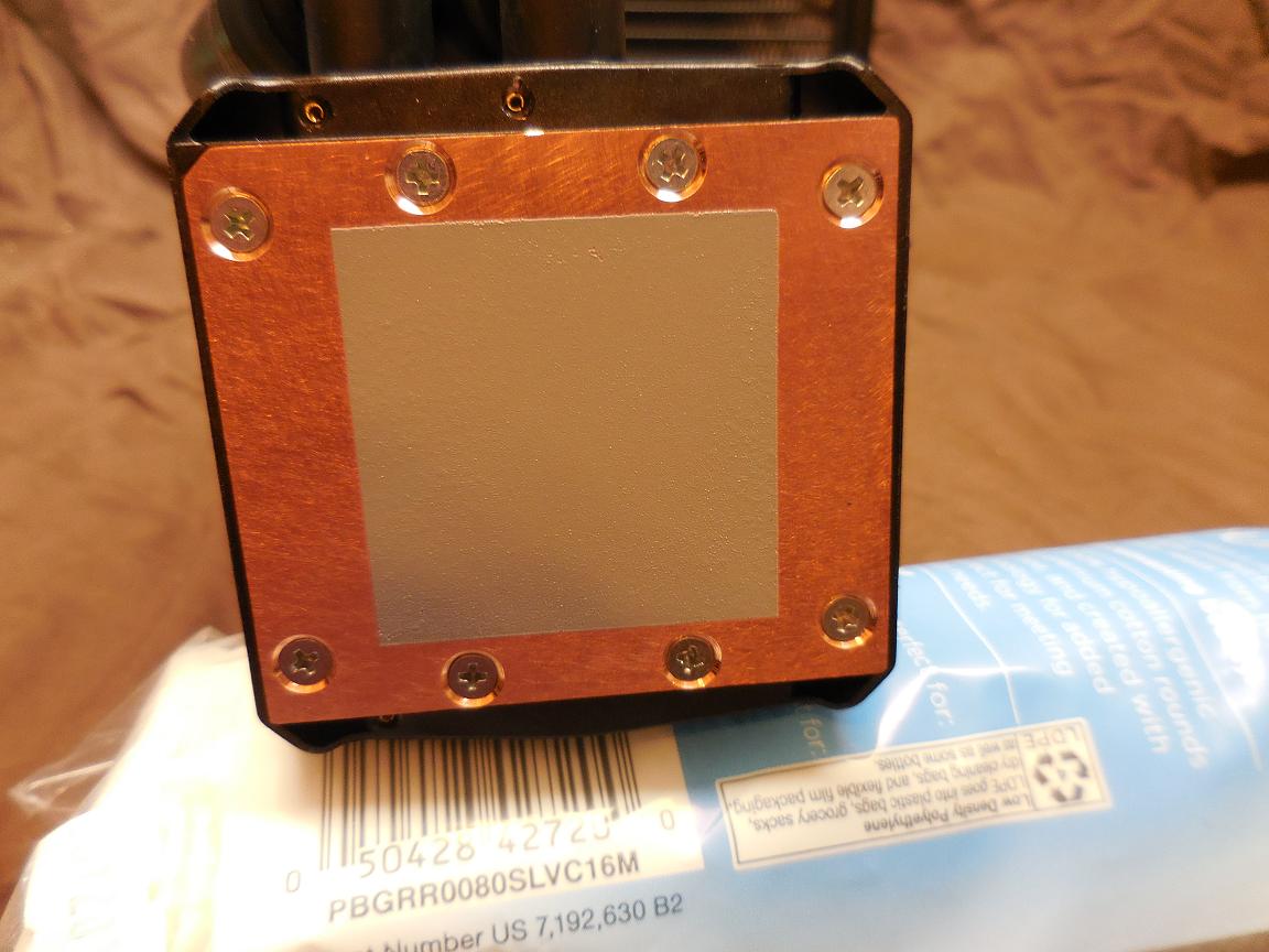

A close up of the retainer ring and cooler. I will remove the thermal compound with 99% isopropyl alcohol and use the Gelid extreme compound instead.

The cooler with the original thermal compound washed off and the Gelid compound with the applicator. This stuff is really hard to work with.You need to get it spread very quickly or it won’t smooth out. It’s also a bit toxic, though non-corrosive. Wash your hands after use. It’s also a bit pricy, about $13US for the tube here.
But it’s supposed to come close to diamond dust compounds for efficiency and rates quite a bit better than Arctic Silver. The surface of the cooler isn’t mirror smooth, but that’s what the compound is for. Most important is if it’s flat. Milled heat sink surfaces warp after a while. If you reuse a heatsink, copper or aluminum, check it with a straight edge and level it with some fine grit sandpaper. I use 1400G, 1200G, 1000G, 800G, and sometimes even 400G wet and dry sandpaper if it’s really warped. Start with the finest and use a piece of plate glass and lots of water with a drop of dish soap. That will show you how warped it is without damaging it. If you need 400G to level it, it’s badly warped. I see that more with solid aluminum HSs.
