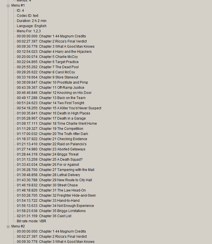

    As mentioned before, how do I omit the menu and certainly not copy it.

  20. Try adding -map_metadata -1 -map_chapters -1
    If that doesn't work upload a sample.
    Sep 2006
    It works but I get a highlighted message that says track mp4 output size not set. Whatever that means.
  22. Show complete log including the command. Is it just a warning and it encodes anyways or does it stop?
