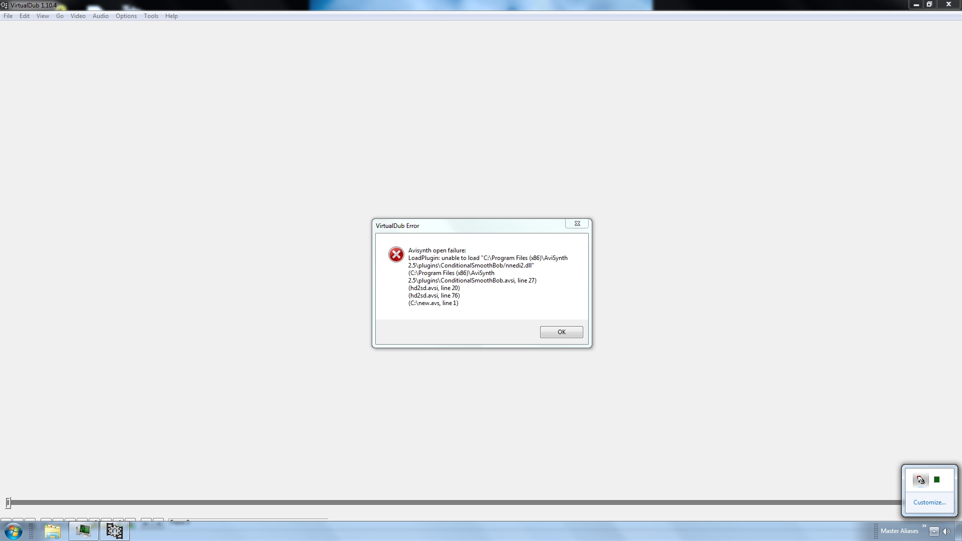

    Today I discovered a pop-up error message.
    Rebooting the computer and reinstalling the program did not help.
    Typically I open a avisynth script file which in turn launches the master video file.
    So, instead of opening the master video file, it gave me this:
    Please refer to a screenshot of the message which should be uploaded and visible.

    Jul 2006
    update
Name:	Error message.PNG
    Jul 2006
    Am I missing a .dll?

  5. VirtualDub is working fine. Your problem is in AviSynth. And it's telling you exactly what's wrong.

  8. Do you have the NNEDI2.dll where it says you're supposed to have it?
  9. Try reinstalling avisynth

    Problem seems to be solved.
    Updated to Avisynth 2.6
    Updated the plug-ins folder.
    Apparently the NNEDI2.ddl vanished so I replaced it where it needed to be.
    A special thanks to all who took a interest and contributed.
    All the best!
  11. Originally Posted by Canon GL-2 Guy View Post
    And that's exactly what the error message told you.
