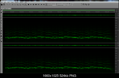

I want to upload a video tutorial on how to play a tune on the electric guitar. My problem is: when I play the recorded wav file, on certain devices (my mobile phone and one of my laptops) the sound is distorting. I noticed that on the same problematic devices, when I play the tutorials of others from Youtube, the distortion also occurs, so it has to be a problem of the properties of the speaker of these devices (the original audio tracks released by bands doesn't distort though). I wonder if I could improve the sound so less distortion would occur?
Find a sample from my recording attached to this post.
Here are some details about how I recorded this:
- For this sample I recorded the guitar with delays and EQ added before the input. However, the distortions also occur when I record in a way that the guitar is plugged right into the input, maybe a little lesser though. (I set the EQ in a way to emphasize high frequencies, maybe that raises the possibility of distortions?)
- The recorded signal never had clipping. Actually what you can see in the sample is the signal I recorded, the only editing I did was doubling the channels, because originally it was mono.
So the playback is okay on my desktop speakers, on my iPad and HP 625 laptop, but it is distorting on my mobile phone and my HP Probook. If you have any ideas how I could make the signal a bit more consumable for the last two devices, I would appreciate.

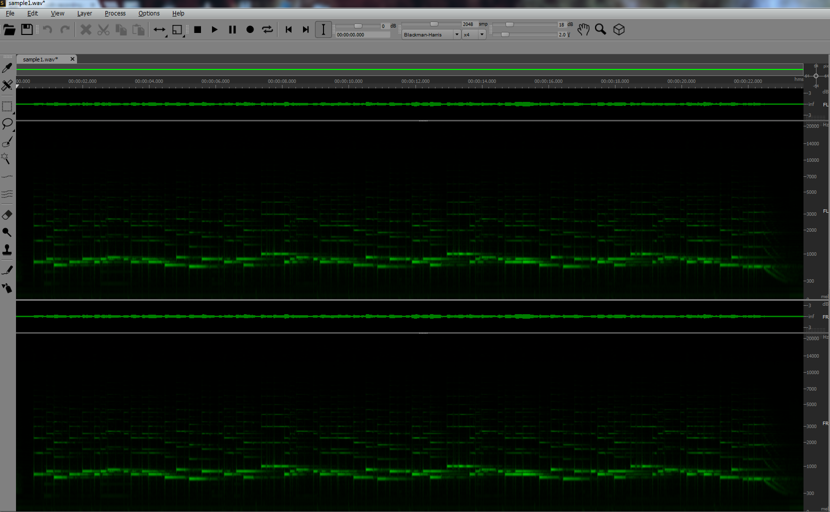

 [Attachment 40867 - Click to enlarge]

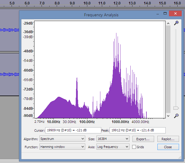

 Agree. Filtering everything below 100 or 150 Hz should do the trick.
	Turn off any audio processing (EQ, normalization) that may be occurring on your phone and ProBook. Make sure you have the latest audio drivers installed.
 What does the distortion sound like?
	Yeah aedipuss is correct no low frequency content that would account for it. Generally this is the reason for why many recordings sound crappy on miniscule speakers.. Just ran it through Adobe Audition and then on my Tannoy 15" ers . Check for any EQ and normalization or any other filters. Later I will transfer it to my iPhone and see how it goes.... SONY 75" Full array 200Hz LED TV, Yamaha A1070 amp, Zidoo UHD3000, BeyonWiz PVR V2 (Enigma2 clone), Chromecast, Windows 11 Professional, QNAP NAS TS851
