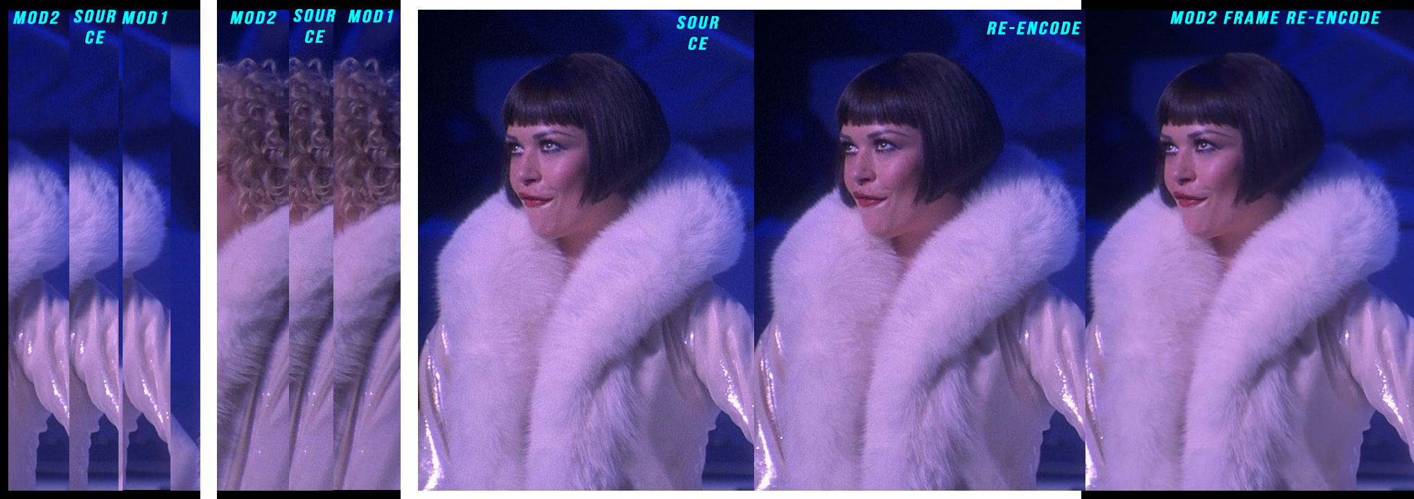

    Here is Lagarith work on left side and source\crf 18 source re-encode\--crf 0 or --qp 0 mod2 border 14px 12px re-encode with x264
    I see the difference, and it is not just re-encode quality loss, as of because re-encode almost identical.
    pictures saved from MPC-HC as .bmp images.

    Yes I see the blurring in your bmp. But there is no blurring when I do it. So there is something else going on in your process, maybe some other filter before encoding, or maybe a mpchc playback or directshow filter
    I'm seeing nothing like that loss of detail in my own encodings, not even in the "testin blur.mp4" file you uploaded.

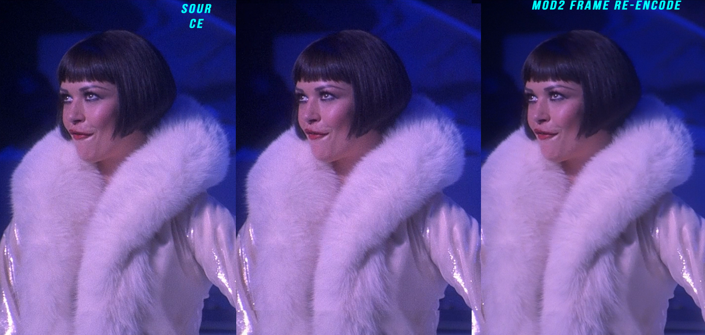

    Here I pasted the same (?) frame from your video in the middle, between your two images:
    [Attachment 40845 - Click to enlarge]
    Even if that's not the exact same frame, other frames around there looked very similar.

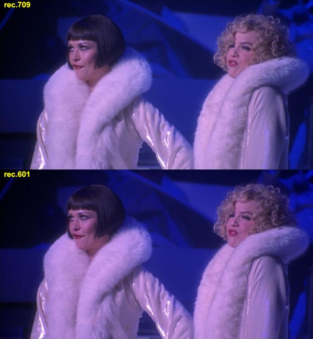

  21. The difference you're seeing in colors is the difference between rec.601 and rec.709 color conversions. The more reddish colors are what you get when you incorrectly convert rec.709 video to RGB with a rec.601 matrix.
    [Attachment 40862 - Click to enlarge]
    The source video you posted doesn't specify the colormatrix but it's probably rec.709 (because that's what's normally used for HD video). In the absence of a colormatrix flag modern players usually assume rec.601 for SD video, rec.709 for HD video. But that's not always the case. Some players always use one matrix, some always the other -- even if the matrix is flagged in the video. Note that this can also be a graphics card setting. Players normally send YUV video directly to the graphics card where the video is converted to RGB for display.
