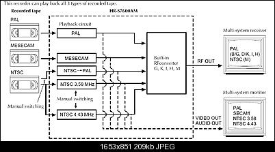

    This is the only high end S-VHS deck JVC made in multi system without having to convert from a standard to another which sacrifices the quality like those expensive low quality worldwide VCR's, It has different circuits inside for each standard and it switches between them, So yes it is true PAL/MESECAM/NTSC, It took me more than 5 years to hunt one down online from an Asian auction website, They are made in Japan and they are supper rare, I hope this addresses your curiosity.
    [Attachment 40840 - Click to enlarge]
    Face it, you got ripped off by industry buzzwords. Look at that chart again.
    NTSC 4:43? Google that.
    Multi-system Monitor? Do you have one of those? I do. It's called a PAL television.
    Wanna play with anything other than NTSC in an NTSC environment?.....spend the big bucks and get a true converting VCR. Any other attempt leads to tears and an empty wallet.

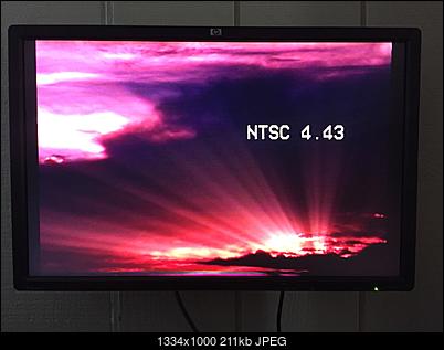

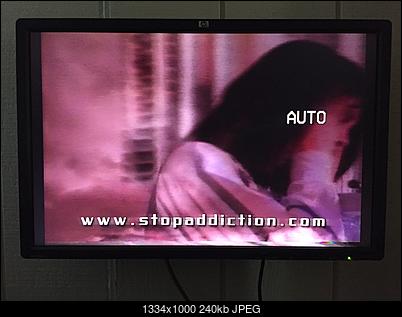

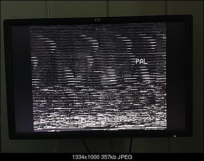

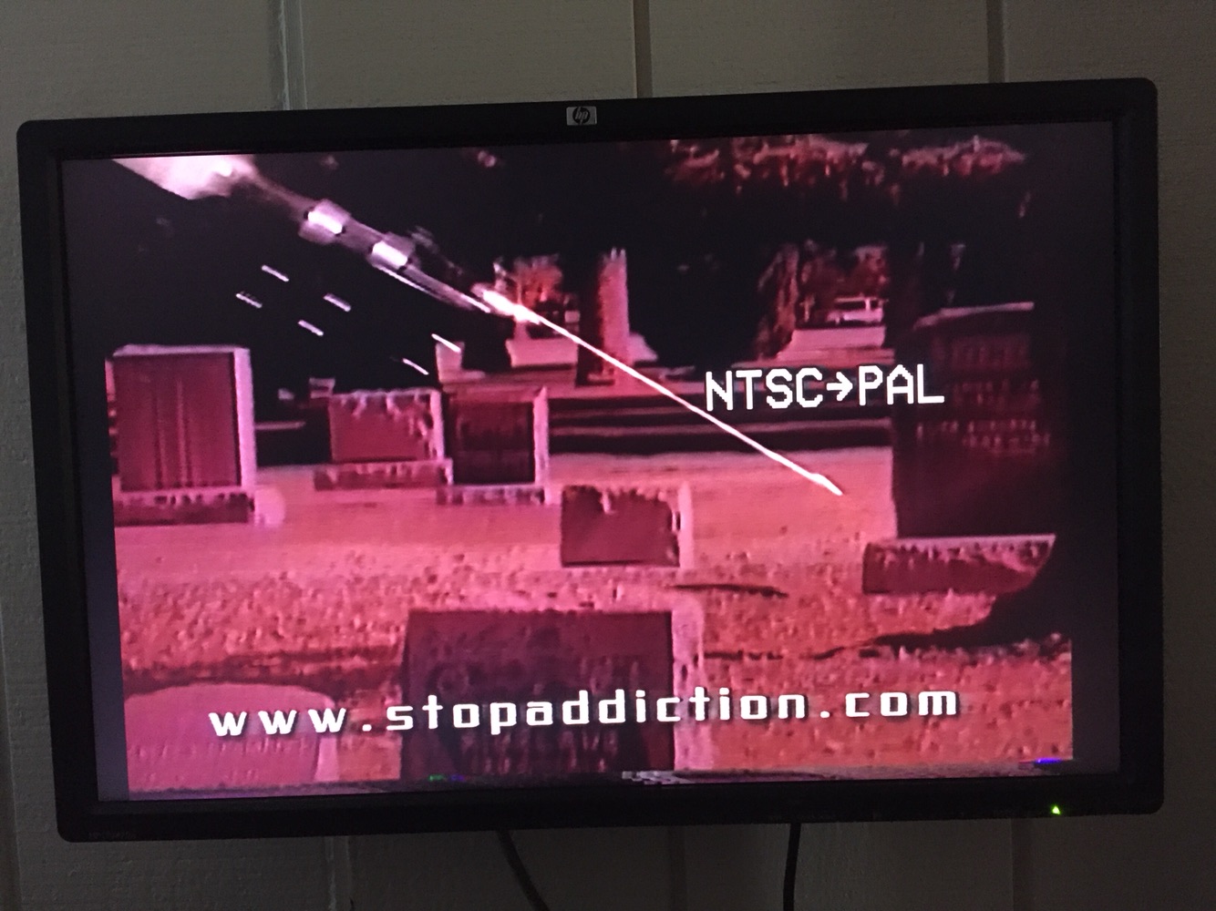

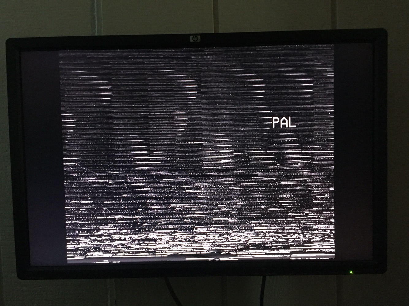

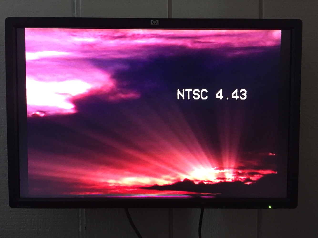

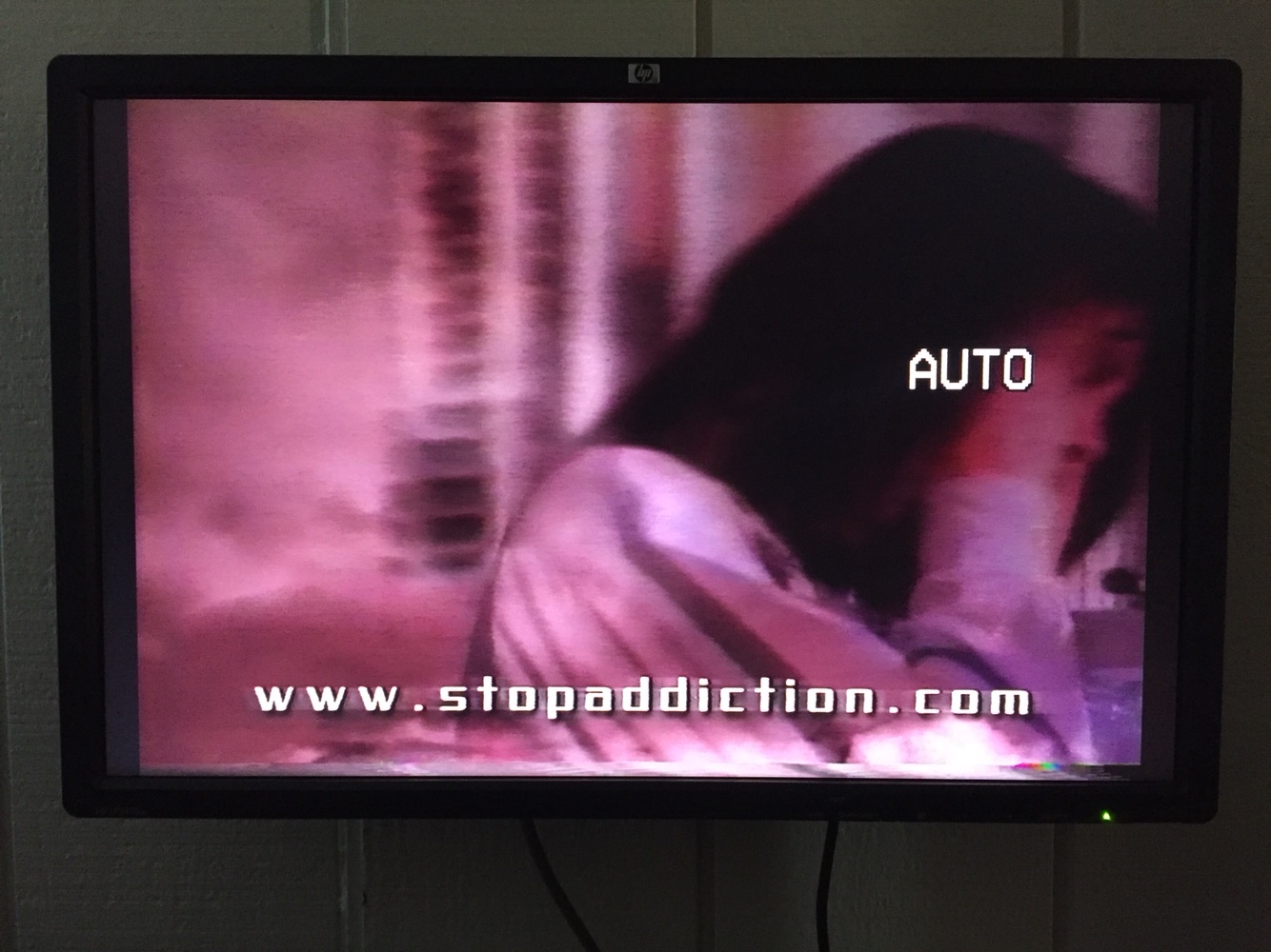

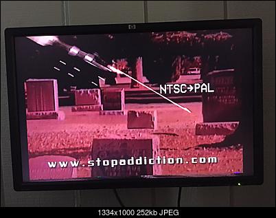

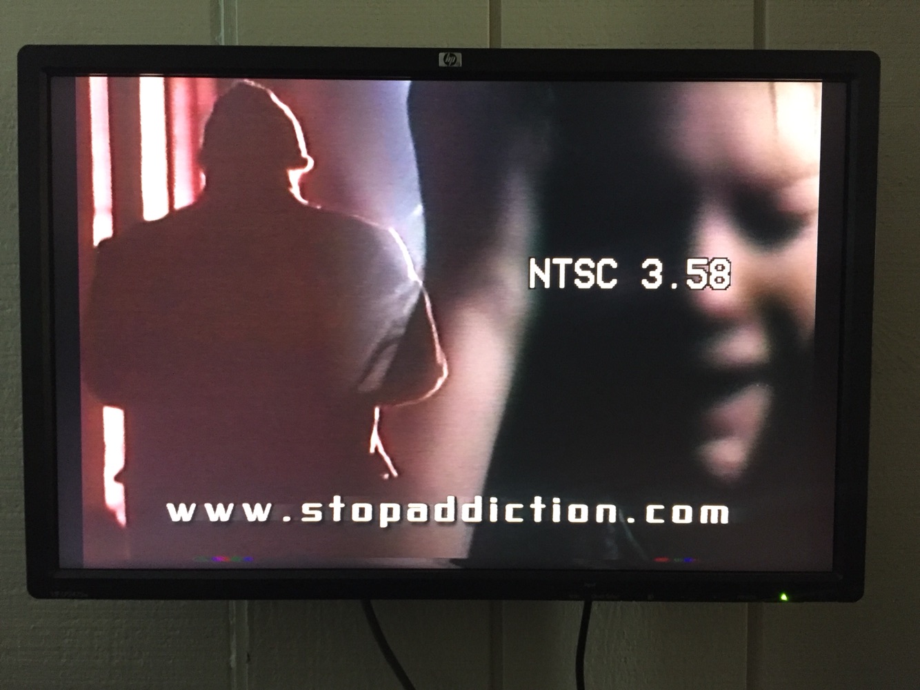

    After doing some research online about video monitors it turns out the monitor I have doesn't recognize non square pixels, it displays them as square pixels no matter what shape they are in, So PAL signal is the closest to 4/3 aspect ratio based on the chroma frequency (no pixel structure in analog video) although it is not perfectly 4/3, I measured it.
