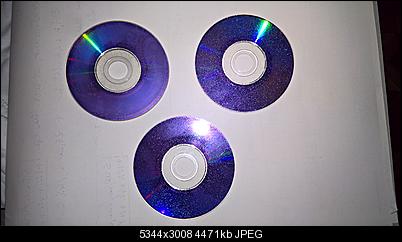

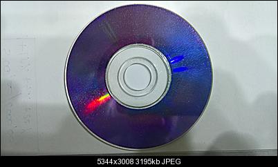

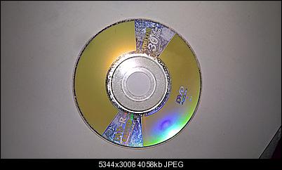

  3. Hello
ID:	40826Click image for larger version
ID:	40827Click image for larger version
    This the DVD pic.
    Aug 2006
    It appears that the adhesive used to bond the top and bottom of the disc together has deteriorated, allowing air and moisture to get inside. I'm sorry to say that there is no way to salvage those discs. They are far too damaged to recover anything.

  6. Member hech54's Avatar
    Jul 2001
    Yank in Europe
    Holy crap.....those are done.
    Aug 2006
    Originally Posted by FLGigi View Post
    I can assure you that the part is cracked on the outside.
    Passing over with a finger, you see very well that is very rough.
    In the picture showing the top of a DVD, there is oxidation visible on the metallic layer inside the disc. Normally this indicates that air and moisture got inside. Your discs are completely ruined. Nothing further can be done with them.
    Likely they were stored in an area with uncontrolled humidity, or where the temperature fluctuated quite a bit, or both. If not, and they were not exposed to any corrosive substances, they were very poorly made.
