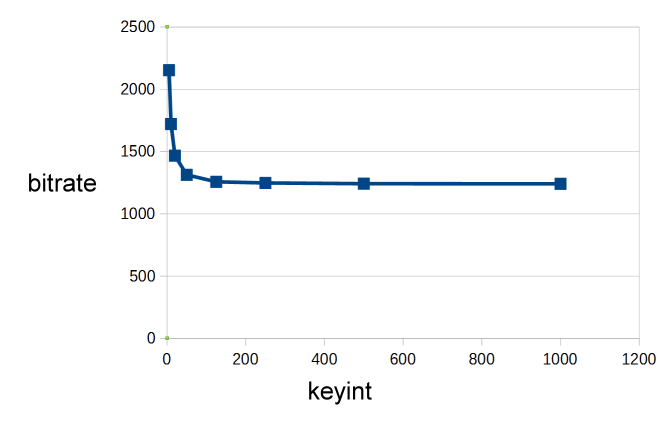

    I ran some quick tests. I didn't have a 50 fps source hand but here's 10000 frames of a 23.976 fps DVD source CRF encoded with different keyint sizes:
    keyint	bitrate
    5       2153
    10      1721
    20      1467
    50      1313
    125     1257
    250     1248
    500     1242
    1000    1241
    and graphically:
    [Attachment 40800 - Click to enlarge]
    A 50 fps source would probably shift the graph a little to the right. And the exact values will depend a bit on the particular video. But the general trend is obvious.

    I used mvtools to double the frame rate to 47.952 fps and encoded with keyint 250 and 500. Added them to the chart:
    keyint	bitrate
    5       2153
    10      1721
    20      1467
    50      1313
    125     1257
    250     1248    1361
    500     1242    1352
    1000    1241
    Very slight relative difference. About 0.5 percent improvement at 24 fps vs. 0.7 percent at 48 fps.
