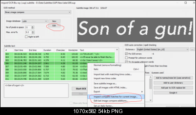

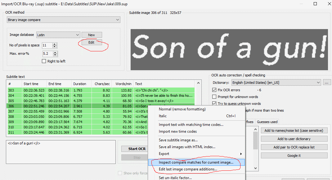

    If you use "Binary image compare" you can click the "Edit" button to edit the character db. If you right-click in the list view, then you have two ways of viewing/editing the character db - inspect matches for current line or edit the last additions (if any).
