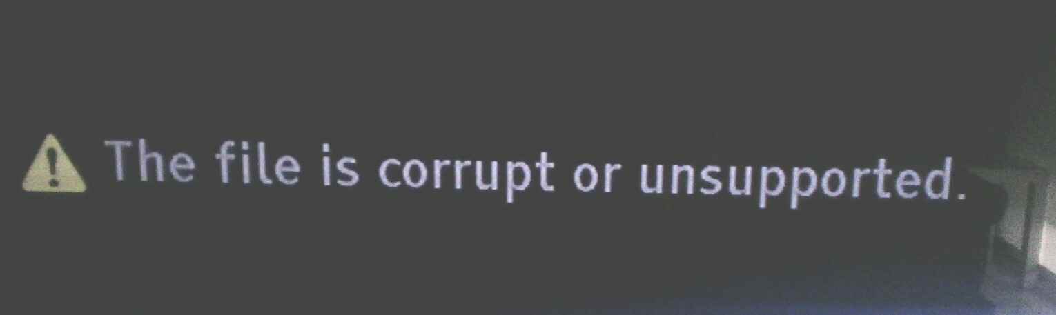

    My standalone player is Full HD 3D Blu-ray Disc player SONY BDV-N590, it can read a lot of video formats, but can't read 1280x544 mkv.
    [Attachment 40780 - Click to enlarge]
    It needs something like 1280x720.
    I just bought it (it's a second hand player), and someday I will install kodi on it, but for the moment I don't know how to do it. So I try to read my movies on a USB device.

    How exactly did you decide it was the resolution the player was rejecting?
    Do you have a similar file that DOES play? Can we have the MediaInfo data from that?
    (I've downloaded the manual for your player and it doesn't mention anything about resolution locks)
    The file is obviously supposed to be 720p (1280x720), so all you'd really have to do is add 88 lines to the top and bottom to get to a standard resolution if that really is what's needed.

    *sigh*
    V_MPEGH/ISO/HEVC
    That's h265, there's no way that old Blu Ray player is going to support that!
    Just load the damn thing in Handbrake and convert it to h264 and the problem should be solved without needing to add borders.

  7. Originally Posted by ndjamena View Post
    *sigh*
    V_MPEGH/ISO/HEVC
    Yes, that's the problem. Not the frame size. You want h.264, aka, AVC. And beware that most players do not support all possible settings (too long GOPs, too many consecutive b-frames, too many reference frames, etc.) that can be used in h.264. You should stick with high profile, level 4.1.

    So you solve the problem, congratulations!
    handbrake 1.0.3 did the job (even though I lost the subtitles), so I could uncrop et mux everything with the demuxed subs. My movie is now ready to be read! Ready-read!
