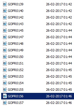

    Last night I imported all the videofiles from my GoPro Hero 5 to my external HDD.
    I simply cut and pasted all the files from the camera's folder to my video folder on the HDD.
    But afterwards I realized all the metadata had been overwriting with the date and time of import - instead of the original record data and time.
    Unfortunately I cut and pasted the files, so I no longer have them on my camera.
    What can I do to recreate the original meta data ?
    .. and most important, does anyone have an idea of why this happened ?

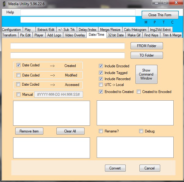

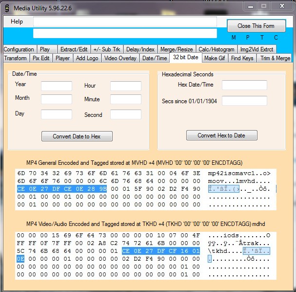

    The 'Encoded\tagged' data is usually retained in an mp4 as ndjamena correctly informed us. Windows 'created\modified' date is often written as the time the video showed up on your PC (the paste time) because Windows assumes it was just created. When you look at the data in your camera, your camera has no windows OS so what you see is the correct Encoded date.
    BTW, if you are looking for where the dates are stored, they are stored as 2 x 32 bit binary codes (Encoded/Tagged) in the MVHD, TKHD and MDHD MP4 atoms.
