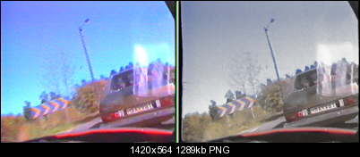

    As you can see there's bad chroma noise/bleeding happening in the picture. And I was wondering if there's any filter for VirtualDub that can reduce this effect?
    I tried the "field shift" plugin with virtualdub, it does help since I can move the chroma to line up properly, but you still get the blue/purple shaders.
    Also, can somebody explain why this is happening? I'm thinking that the color-burst signal on the VHS-tape is damaged so the colors in detailed areas are getting distorted?
    Help very much appriciated! :)
    /Solouplay

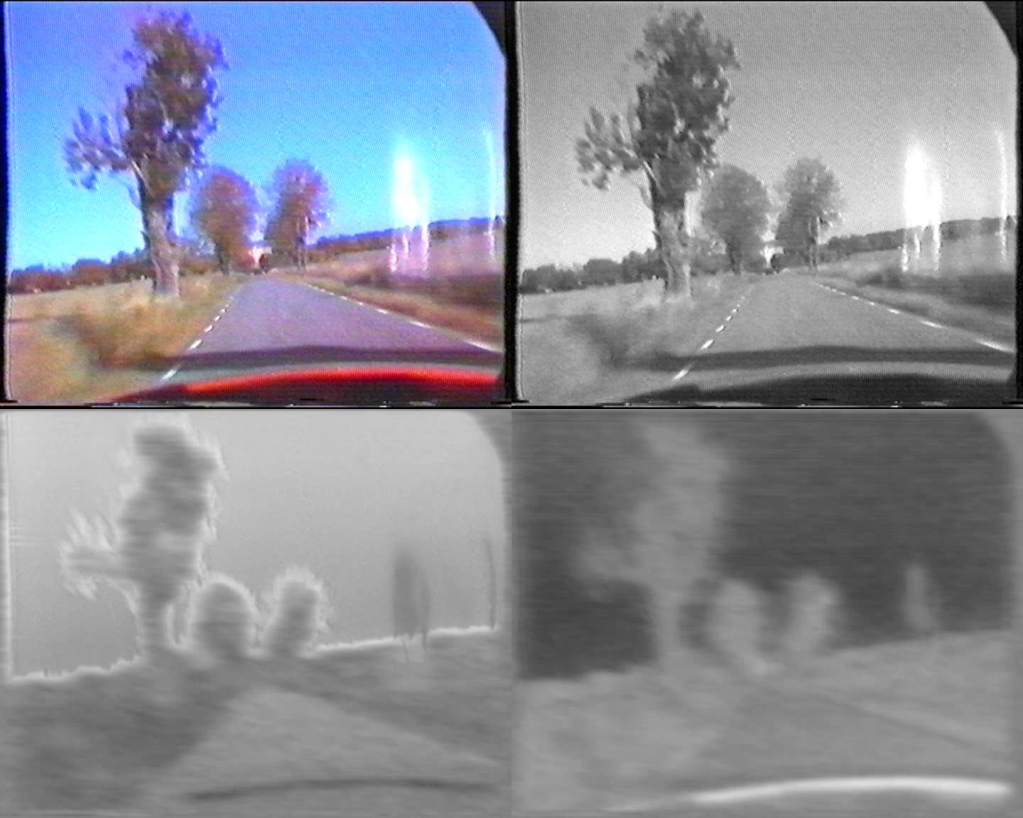

  12. You've encoded interlaced video with an h.264 encoder in progressive mode. That has caused the two fields of the chroma channels to blur together. There's also a lot of chroma carrier crosstalk in the luma channel causing herringbone noise. Those are things you should fix the next time you capture, but not the main issue you're asking about here.
    There's something definitely wrong with the U channel. It has severe halos at many edges:
    [Attachment 40758 - Click to enlarge]
    That's the original color frame at the top left (simple bob deinterlace), just the luma channel at the top right, the U channel at the bottom left, and the V channel at the bottom right. You can see the crosstalk in the luma channel. And the V channel looks about normal for VHS (ie, not sharp). But I don't know how those halos got in the U channel. Dehalo_alpha() on the U channel might help.

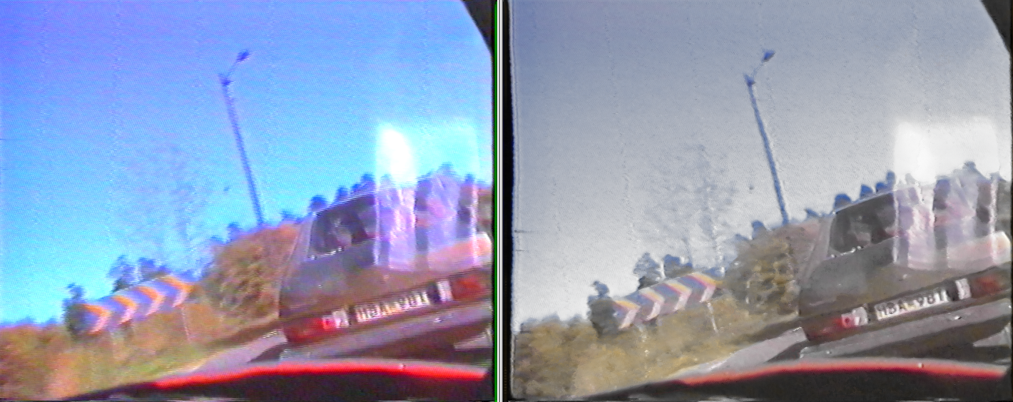

  13. Here's a dirty trick, invert and copy the V channel to the U channel:
    YtoUV(VtoY().Invert(), VtoY(), last)
    [Attachment 40759 - Click to enlarge]
    The chroma could be sharpened a bit too.
    That looks great! Very good work!

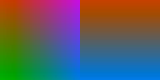

  19. Here's an example of what happens with YtoUV(VtoY().Invert(), VtoY(), last):
    [Attachment 40770 - Click to enlarge]
    On the left is the full range of colors, on the right the result of the transform. You can see that greens and purples have been lost, replaced with browns and blues.
    Okay, yeah that won't be good for moving images.

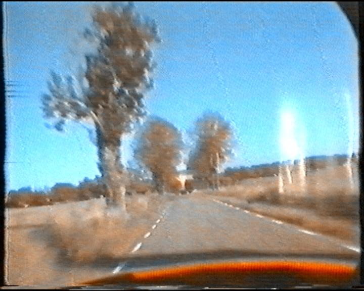

    So now I got the sharpening filter to work. Is there any other filters you would recommend? :)
    Mar 2015
    Well at any rate it sure is getting better! Again, thanks for all the help! :)
