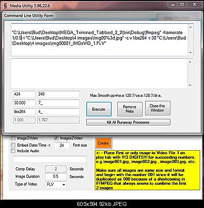

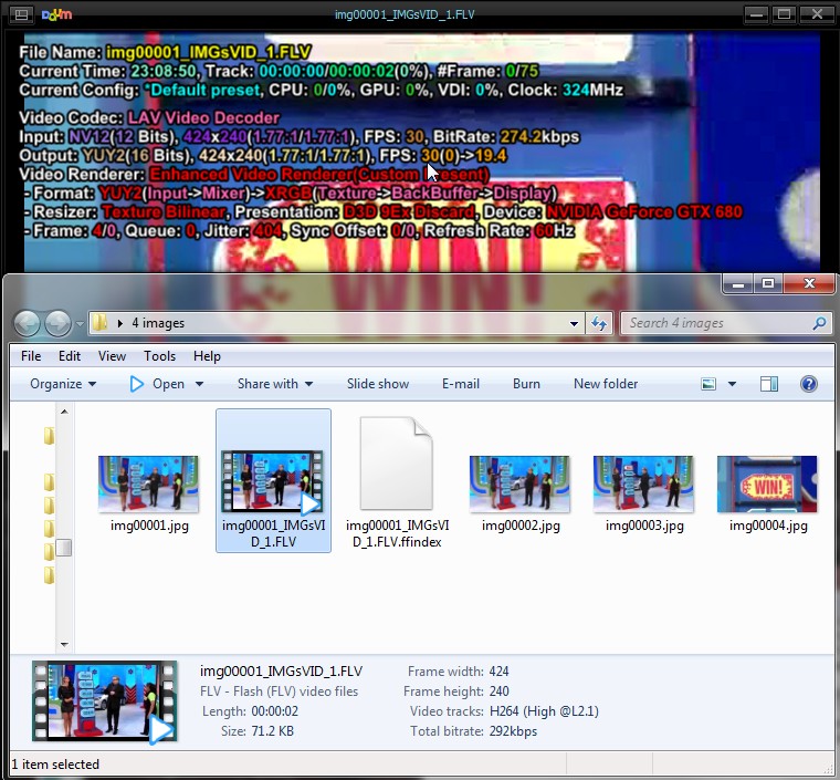

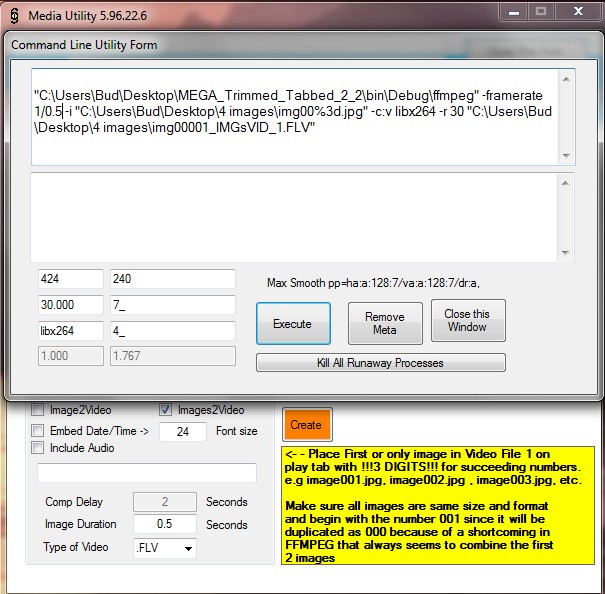

    Testing on my simulator shows you should put the '-framerate 1/x' before the '-i input' for input rate and -r xx for output rate after '-i input'
Name:	ScreenHunter_210 Feb. 24 23.11.jpg
    And it produced a video 2 seconds long at 30 fps
Name:	ScreenHunter_210 Feb. 24 23.09.jpg
