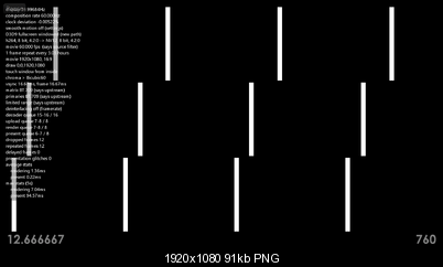

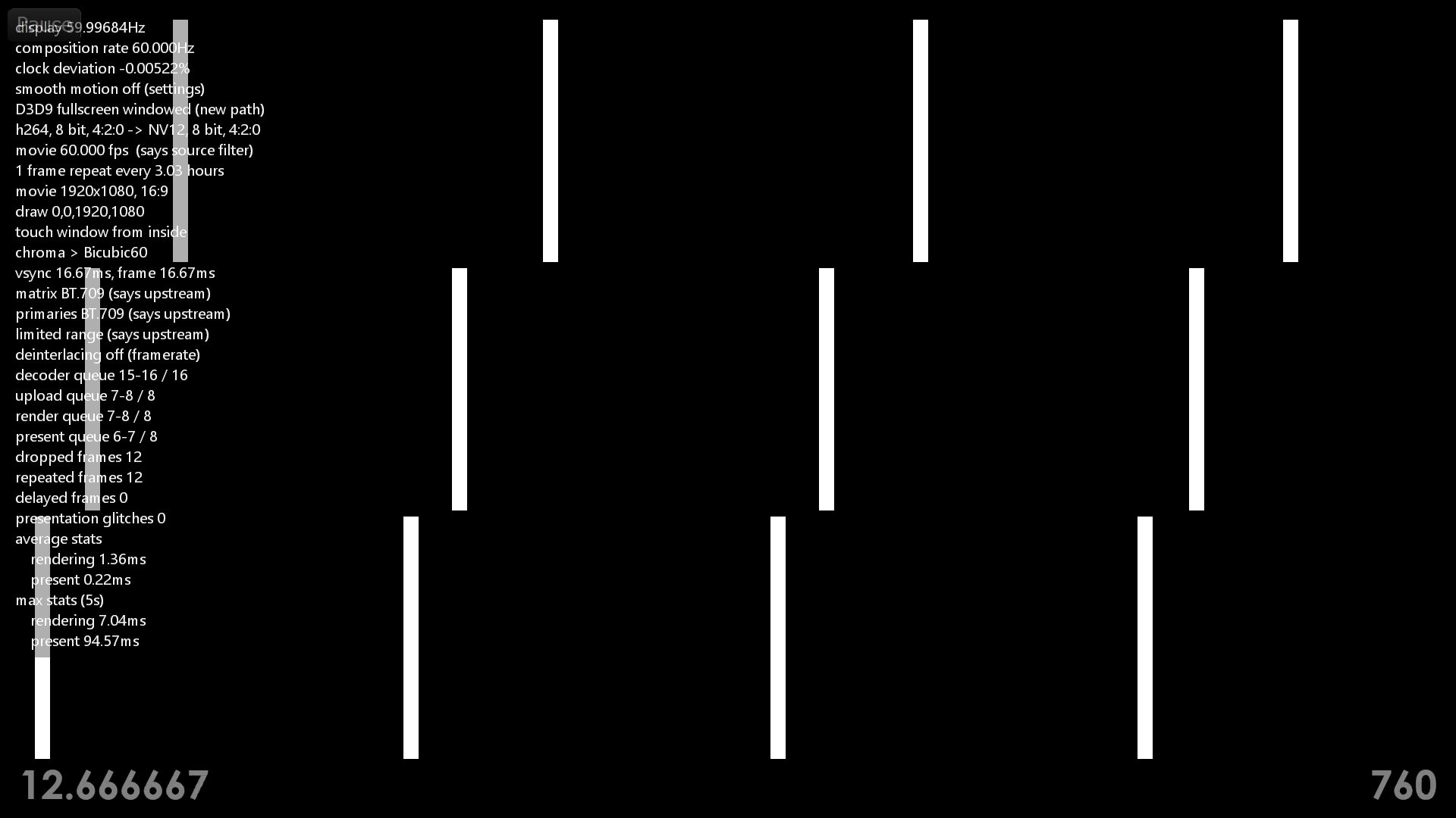

    I've tried a lot of things, at first I used SVP but I gave up on that really quickly, huge frame drops. I tried various madVR configurations I found on the internet, from really high-end ones, to the absolute bare bones. With some settings, I can play certain videos (even with SVP) in windowed mode without experiencing frame drops, but when I go fullscreen, the frame drops come flooding in. What do I do?
  2. 1. run "restore default settings.bat"
    2. start video in fullscreen
    3. press ctrl+j to activate OSD
    4. press ctrl+r to reset counter and let it run an bit
    5. make screenshot and post it here

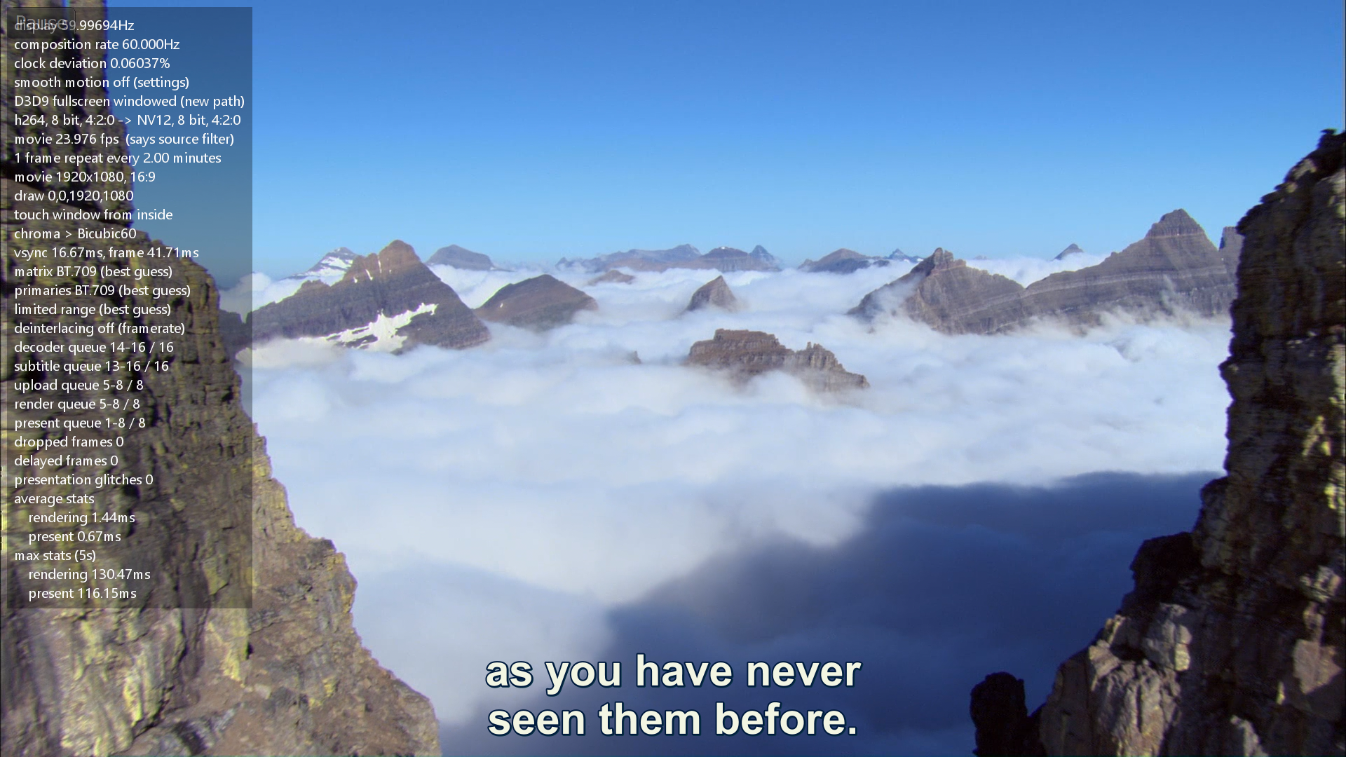

    First one is 60fps, second is 23-24fps.

    Reset settings like explained above. Then in settings: rendering>general settings>enable automatic fullscreen exclusive mode. That said, according to you it runs fine in windowed mode but not in fullscreen so this is kinda strange. The queues also seem to be filling up although in the second screenshot the present queue drops down to 1-8.

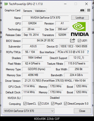

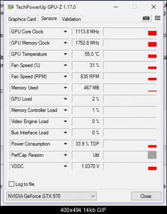

    Yeah, I use MPC-HC, here are my filters (from top to bottom): ReClock Audio Renderer, madVR, Audio Switcher, LAV Video Decoder (internal), LAV Audio Decoder (internal), LAV Splitter Source (internal).
    The DPC Latency Checker tells me that "This machine should be able to handle real-time streaming of audio and/or video data without drop-outs.". My current latency seems to average between 501-562 µs. Absolute maximum is 621 µs.

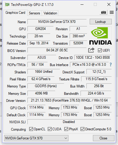

    Results from GPU-Z are as follows: Click image for larger version
ID:	40668Click image for larger version
  9. Then I'm pretty much out of ideas. There have been similar reports but without any obvious solution.
