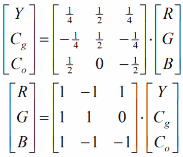

I doubt that. YCgCo is (if I am not completely wrong) just another case of YUV, just a matter of matrix coefficients, similar to Rec.601 vs. Rec.709, defining the extents and space angle of the YUV color space cube, and how much and at which intersection positions it covers the RGB space cube. Most AviSynth functions (including those provided by plugins) operating in any YUV configuration won't care about the coefficients and just rely on the color model YUV as such. Only except for those which are specifically made for colorimetry conversions.
The existence of ManualColorMatrix apparently confirms my opinion. Convert YCgCo to RGB using:

There are no coefficients (and there is no floating point) in YCoCg24.YCgCo is (if I am not compltely wrong) just another case of YUV, just a matter of matrix coefficients, similar to Rec.601 vs. Rec.709
Did you ever learn vector maths? Do you even understand at all which coefficients people mean when they talk about the conversion between color spaces in theory? Implementations in software don't matter, the computer is off.
Code:ManualColorMatrix(2, 1.0, -1.0, 1.0, 1.0, 1.0, 0.0, 1.0, -1.0, -1.0, 0.0, -128.0, 256.0)

Your remark sounded to me like you wanted to express that YCgCo is remarkably different from YUV. But to me, YUV is just a concept comparable to Left/Right encoding vs. Mid/Side encoding of audio: Luminance as a (weighted) sum of channels, and Chrominances as differences between neutral luminance and a color in hue (angle) and saturation (radius). In the HSL model, you would indeed report radius and angle.
If you wanted to point at a difference between YCbCr and YCgCo instead, then I can agree with you: The space tilt is indeed different. Therefore we have different matrix coefficients for YCbCr Rec.601, YCbCr Rec.709, and YCgCo. But all of them are a special case of the same color model: YUV. And AviSynth doesn't care much about the specific coefficients. In most cases, it only separates RGB from YUV. You have to tell the encoder which colorimetry to assume if it doesn't guess right from e.g. the resolution, as you may already do when processing Rec.601 vs. Rec.709 in an up- or downscale.
