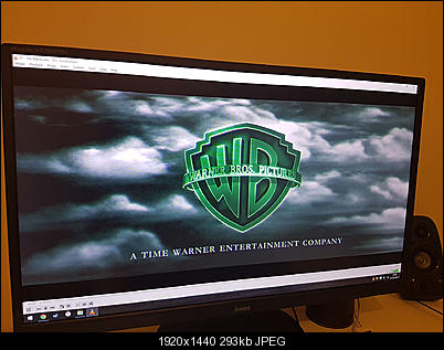

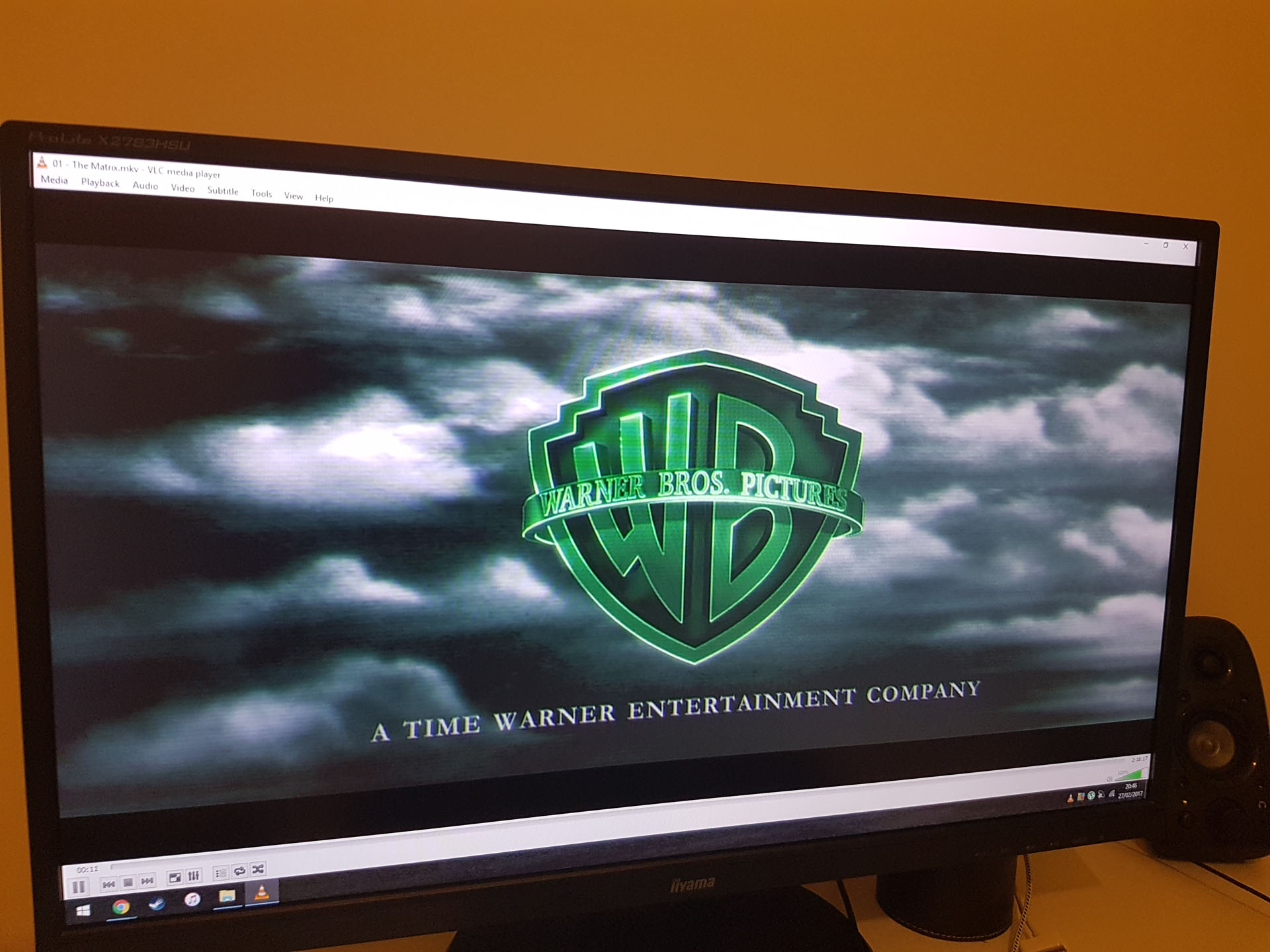

  8. dunno how else to explain the problem so ive attached an image. as you can see the ratio is correct but the picture is completely missing the bottom half, YET perfect when i play back on my pc.. i have hundreds of films and only this one causing me problems..as you can see, same film, but plays differently on 2 devices..never had a problem like this before
