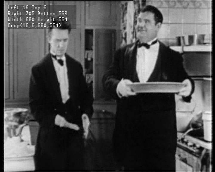

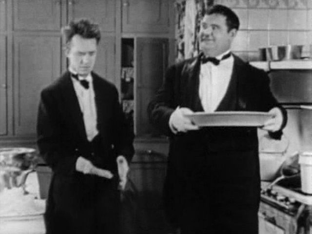

  14. "CropResize 2017-03-09" adds a preview function for the cropping. It's simply the cropping preview displayed by autocrop.dll with resizing disabled, as it doesn't seem to make sense to show a cropping preview if the video is being resized as though it was actually being cropped.
    A 4:3 PAL DVD, cropped and resized with the following:
    CropResize(640,480, InDAR=15.0/11.0, Cthresh=110)
    Here's what you see with the "CPreview=1" setting. Note that it's no longer being resized.
    CropResize(640,480, InDAR=15.0/11.0, Cthresh=110, CPreview=1)
Name:	CropResize Preview.jpg
    Edit: Doh! I spelled CPreview wrong in the script. Fixed.
