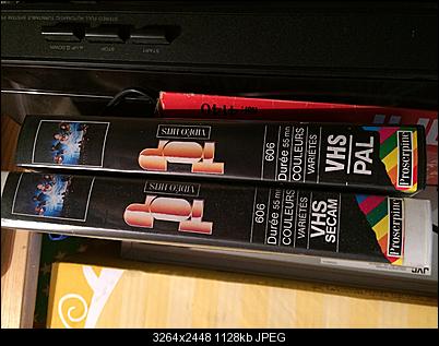

    So you are looking for help with SECAM(L - France) and PAL?
    That's a shame....I know nothing about that.

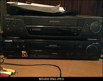

    Yep....know nothing about that.....wish I could help.
