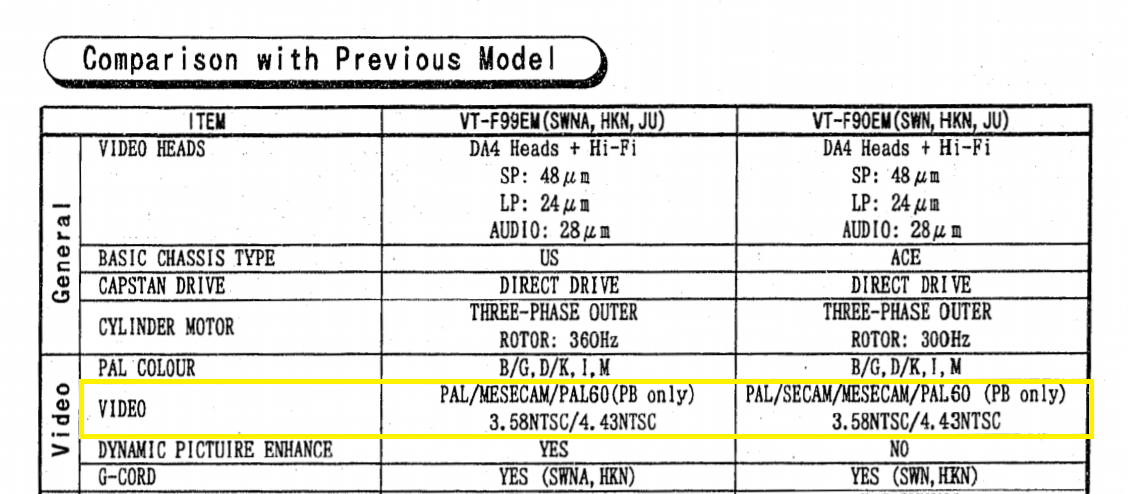

    I'm not using any standard signal equipment. I use a ADVC110, it accepts NTSC, PAL, SECAM inputs. Hitachi VT-F99EM should be playing NTSC and SECAM tapes in FULL COLOR through it.
    VT-F90EM plays SECAM according to the manual you linked, not the VT-F99EM, So you bought the wrong model:

  5. Originally Posted by dellsam34 View Post
    Thanks. Will keep a lookout for this model.
