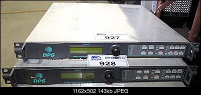

    Yes. My DPS-470AV has an Extreme Head Switch mode for consumer tapes, but it's still not anywhere near as good as the DVD recorders or Digital8/MiniDV cams that were designed specifically to support people's horrible tape collections.
    Originally Posted by DPS-470 manual
    TBC Mode
    Enables adjustment to the VCR circuit time constant.
    • Normal (Default): used for high-end broadcast VCRs.
    • Head Switch used for home type or extreme head switch VCRs.
Name:	DPS-470 'borrowed' image.jpg
