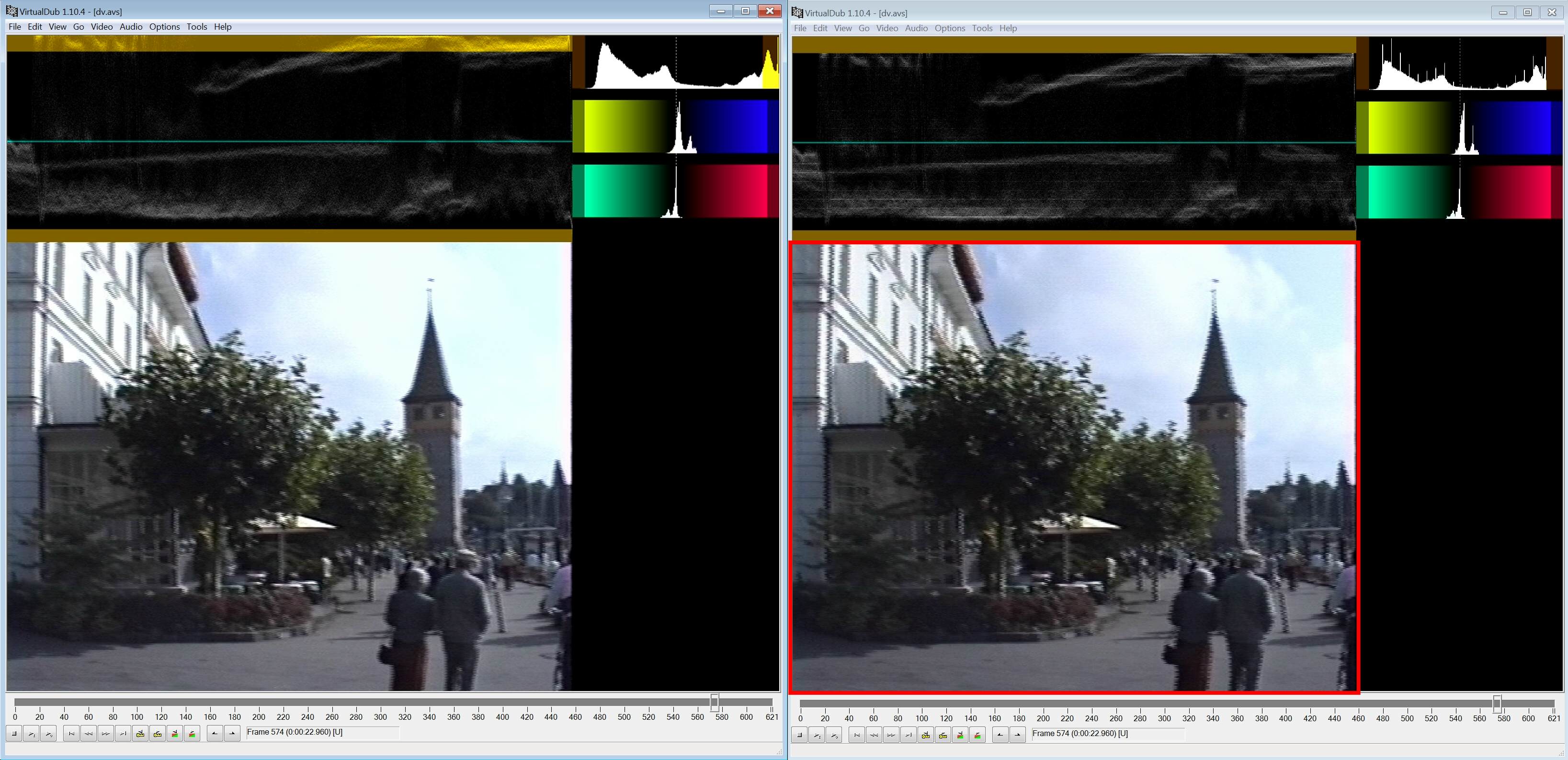

  3. The problem isn't that they're less than 720x576, they're much bigger. For example, in this image:
    [Attachment 40571 - Click to enlarge]
    the video image (outlined in red) is approximately 1178x936.

    It's what I have tried to explain they have been obtained with a screen grabber utility in a 4k monitor 3840x2160 resolution

  9. Originally Posted by FLP437 View Post
    You scaled the frames in VirtualDub. If you want someone to analyze the images you need to post them 1:1. Do what you were told long ago: use Video -> Copy Source Frame To Clipboard (Ctrl+1) then paste from the clipboard into an image editor and save as PNG.
    The reason you got different scaling with two instances of VirtualDub is because one was using DirectX and the other not. I recommend you turn off DirectX acceleration in VirtualDub to prevent this. Options -> Preferences -> Display -> Use DirectX...

    @jagabo
    If the scaling you say I have done is generated by directx and if virtualdub with unique settings generates two instances one with directx and the other without, I assume it can be true .Also the windows dimension of each instance could have not been exactly equal.
    If you are saying I have used in virtualdub or avisynth a scalling filter I can assure you I have not, but I cannot force you to believe it and Im not interested to argue about this detail as we are going anywhere with it and we lose the large picture. The idea with the previously presented images was not that they were images for work but only to be visualized and to detect any defects however I assume I should have posted individual and lossless images. Related to direct virtualdub extraction and PNG I dont think I have posted any image after the recommendation to do it, so this insistence seems somewhat extemporaneous and not necessary.
    To extract a direct PNG from virtualdub I prefer I different approach , select and mark two adjacent frames to isolate one frame, export using image sequence in PNG assuring colorspace is RGB24 or 32 and you are done no need to external picture edit program, if I use the proposed process due to the large workplace I still have to crop to get the original dimension, for me its more complicated.
    Also the images you select have been the ones processed with your function wave and history the others are the ones Im referring always and they are almost raw and are related to avisource and ffmpeg the other only differ by levels using and are more strongly processed.
