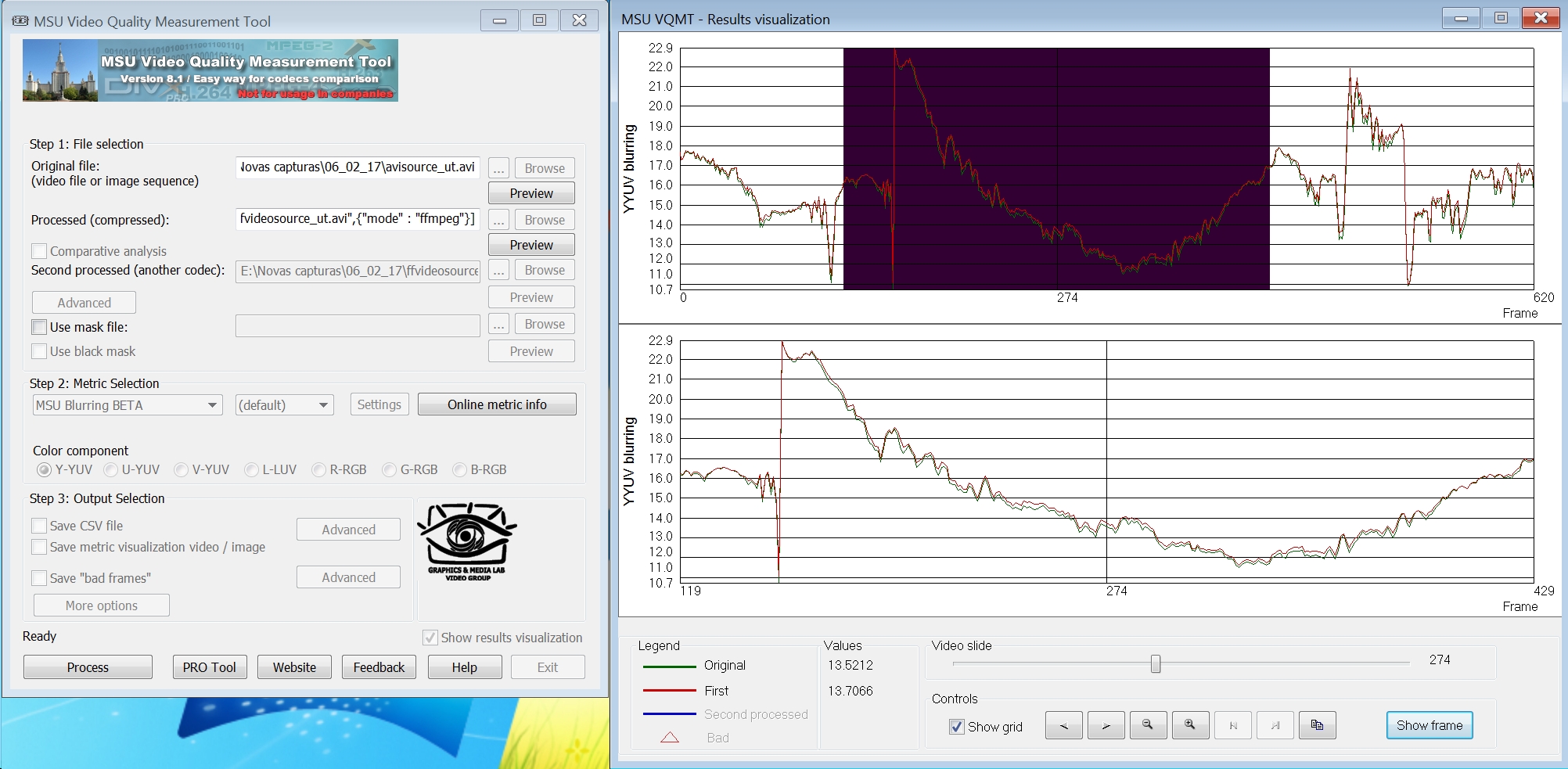

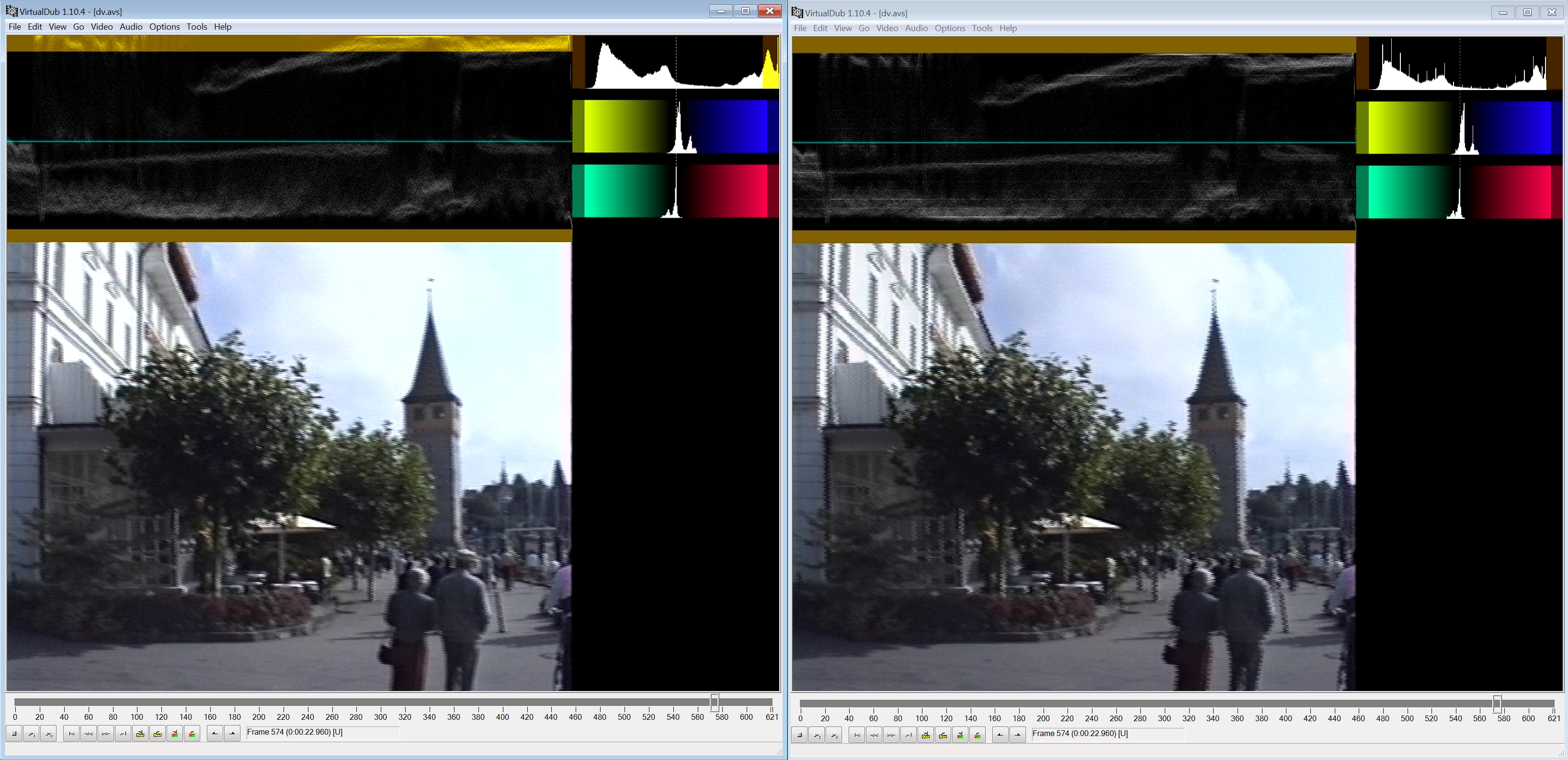

    Fig1- DV luma 16-255 raw left - corrected right
    Fig2- avsource_cedocida_left vs FFmpeg right
Name:	DV luma 16-255 raw left - corrected right.jpg
Name:	avsource_cedocida_left vs FFmpeg right.jpg

  8. The difference in decoders is interesting.
    Theoretically, cedocida (if forced or set to YV12 for PAL DV) and ffmpeg should give identical results. But in your screenshot I can already see vertical artifacts . I'm wondering if something else is going on, for example different resizer for the screenshot.
    How did you decide on decoding the "original" for the MSU tests ? Because that could skew your results if there was indeed a difference between decoders

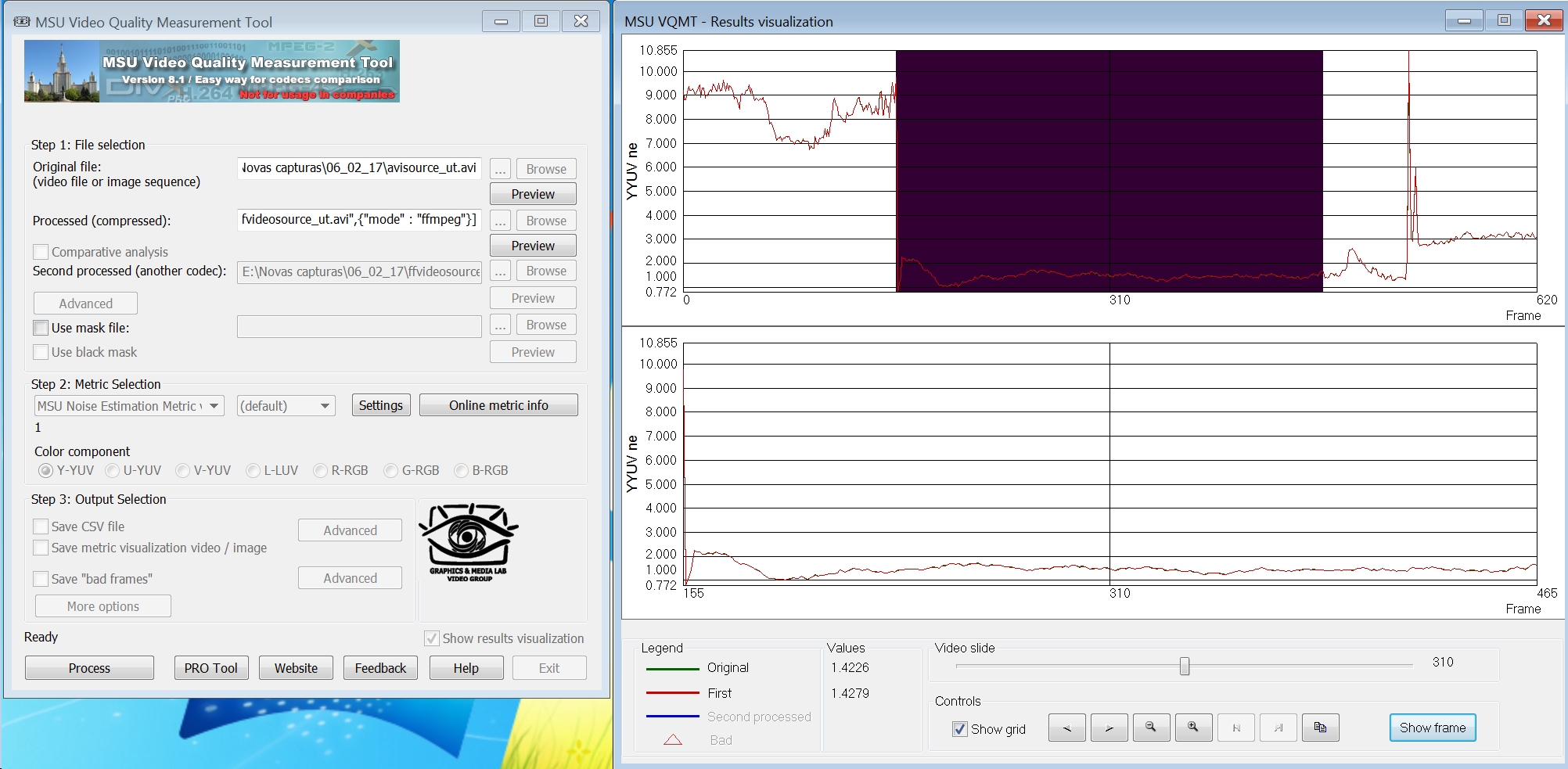

    The difference seems minimal but even so!.. I have used MSU because I didn't saw any difference with naked eye.
    I used a small script to load the dv file and used alternately avisource or ffvideosource selected 4.2.0 yv12 and utvideo YUV420 BT.601 VCM in virtualdub and made two lossless utvideo files I tested with MSU. the FFmpeg almost doubles the speed of avisource ( 220 fps vs 120 fps)
    #AviSource("D:\DV\base.avi", fourCC="DVSD", pixel_type="YV12")
    ffvideosource("D:\DV\base.avi")
    SmoothLevels(16, 1.0, 255, 16, 235)
    In the previous results I think I have not used smoothlevels, perhaps levels or nothing at all, I repeated the tests with smoothlevels now which provides a very smooth histogram without spikes and the same small differences still persist.

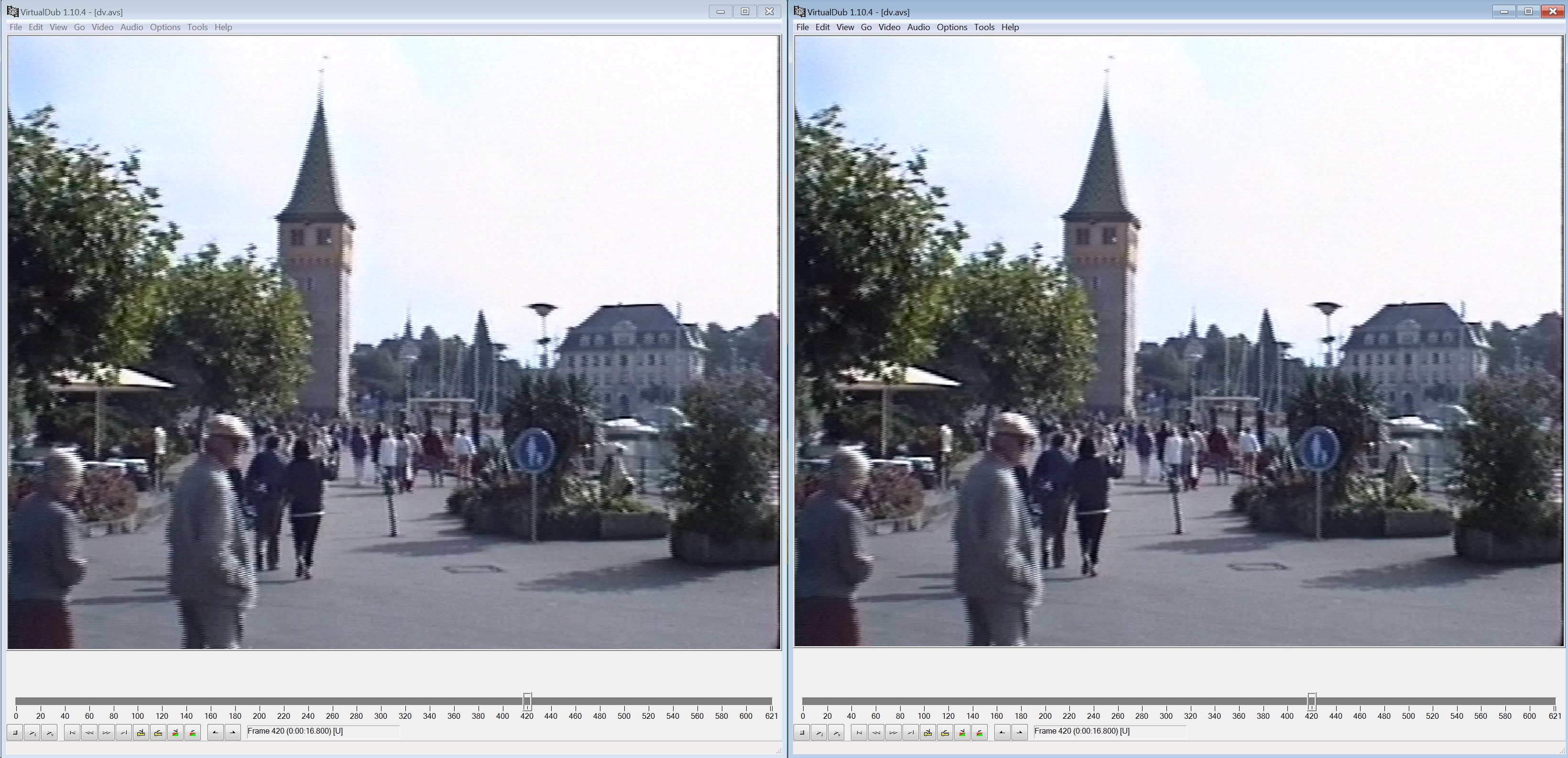

Name:	screen_2017-02-16 03.42.33.jpg
Name:	screen_2017-02-16 03.43.21.jpg

    But you're testing against UT Video, now defined as the "original" for testing purposes. How did you make the UT Video version ? Whatever decoder you used for that will score higher
    For example ,
    1) DV => cecocida => UT
    2) DV => ffvideosource => UT
    cecocida will score higher in (1), but ffmpeg will score higher in (2) , no matter what metric you use

  14. I agree there's a visible difference between the left and right images. But it's the scaling. The left is point resized, the other is probably bilinear.
  15. If you have internal DV codecs disabled in vdub, it will use the VFW codec with the highest merit when you open a file natively (not through avs). (options => preferences => prefer internal video codecs over installed third-party DV and MJPEG) is DISABLED
    Then with an AVI loaded directly, File => file information will report which VFW decoder is being used by vdub. That will also be the same one used with AVISource()
    But do you understand the MSU test isn't useful ? You don't have the "true" original, before the DV compression. You only have the original DV recording from the camera (not the raw sensor data prior to DV compression) .
    So you can't use MSU to test DV decoding properly, because you're 1 generation removed. Whatever decoder you choose to decode the DV recording to make the UT video version , will score higher . (The original DV has to be DEcoded with something for you to test) . So MSU testing set up like that doesn't provide any useful information
    But I can confirm there are microscopic differences between the 2 decoders, just not to the magnitude depicted in the screenshot.

    The script isn't resizing but the images you posted don't have the videos' frame sizes as 720x576. So they have been resized.

    The images have not been resized they have been cropped to get rid of the borders what I think is a passive operation and don't introduce any other modification on the image.

  26. Don't scale the images before posting. Post PNG images (lossless) not JPG (lossy). Use ConvertToRGB(interlaced=true) in AviSynth to control the YUV to RGB conversion.

    Well I have not been scaling images before posting I do have a 4k monitor and the images were obtained with a grab screen utility as I had two instances of vdub running two different scripts the utility can grab also in png.I will try the converto rgb only to control image on monitor not for saving ,thanks fot the idea.

  28. Originally Posted by FLP437 View Post
    Then why aren't the portions of your images that contain the video not 720x576?
