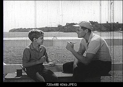

    I'll show you an example pic.
    So far I have this:
    LoadPlugin("C:\~\DGDecode.dll")
    LoadPlugin("C:\~\descratch.dll")
    MPEG2Source("C:\~\video.d2v")
    Descratch(mindif=1)
    before
    after

    Thank you, johnmeyer. Some very nice work there! No I don't have access to the original reel. It was telecined by a TV studio tech & given to a movie collector in the U.S. and then passed down the chain to my friend here in Australia - who I am trying to help by cleaning it up somewhat. I have used avisynth quite a bit in the past so thought I'd give it a go.
    Yes the vertical scratches are quite nasty, Descratch works a little but like all filtering it is a fine line.
    I'll keep plodding away at it. Thanks for the links. I have yet to try RemoveDirt. Finding all the bits and pieces needed is quite a challenge!

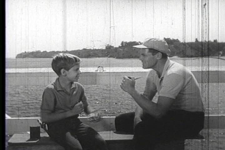

    I then briefly tried the Descratch filter on this restored material, and it did seem to do quite a bit. However, I don't have time to play around with all the settings. I used these settings:
    descratch(source,asym=10,mindif=4,maxgap=1,minlen=25,maxlen=2048,maxangle=5.0,border=2)
    It definitely removed quite a few scratches, but did a lousy job blending the result after removal, and it missed the big huge scratch.

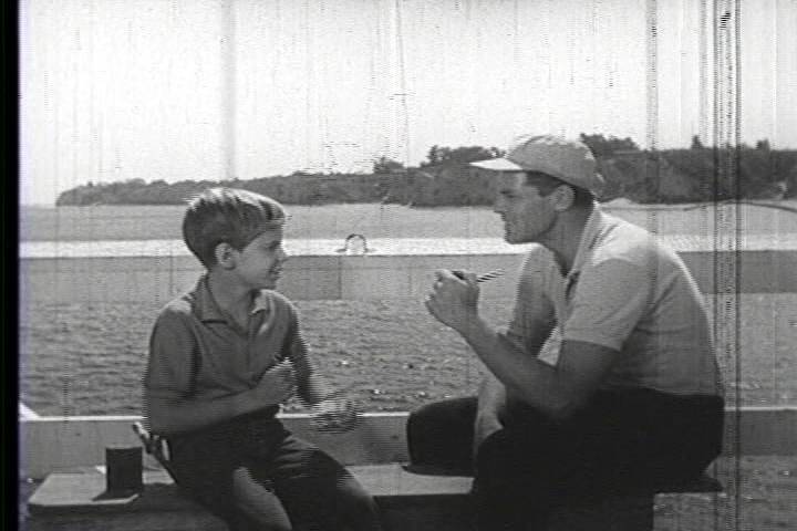

    Here is one frame from the original, after IVTC:
    Here is the same frame after running it through the film restoration script and applying the Descratch filter:
    [edit]In looking at this result, I applied too much sharpening.[/end edit]
    So, this gets you to the point where you can concentrate on the scratches. Try playing around with the various Descratch settings. I wasn't able to produce a result that was better than the original and, in fact, the result was considerably more distracting. Perhaps others will have other plugins to suggest, or Descratch settings that will work better than what I tried.
