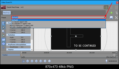

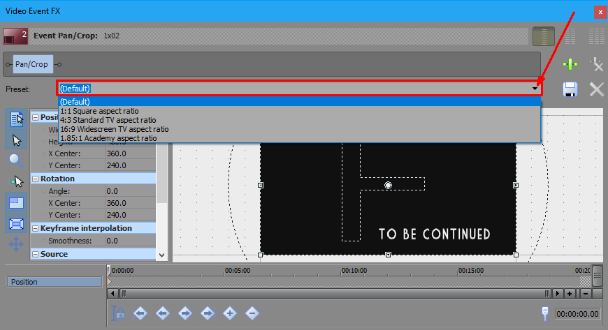

    I have a video that I have split up. There are like a dozen splits.
    I applied the pan/crop effect, but it only applied to the first split segment.
    There is a little green pan/crop icon in the segment timeline.
    I tried to right click -> Delete, but there is no such option.
    If I click it, the pan/crop window opens, but the "delete" is disabled.
    THIS IS DISABLED
    1) How do I delete this effect?
    2) How do I then apply pan/crop to all split segments at once?
  8. You delete the fX by clicking on the button you highlighted.

  9. Member awgie's Avatar
    Sep 2008
    Lanarkshire, Scotland
    As he said, the delete button is greyed out (disabled) for the Pan/Crop effect. Maybe that's not the case in Pro, but it is true in Movie Studio Platinum.
    To reset the Pan/Crop for the selected event, I click on the preset box and select (Default).
    Note: If you've created any keyframes in the Pan/Crop window, you'll need to delete those first before resetting the preset.

    Apr 2015
    Vegas Movie Studio 16 Platinum
    I've learned you can NOT delete Pan/Crop.
    That is mandatory, so if you change it, you can only restore it back to default.
    You can not delete Pan/crop.
