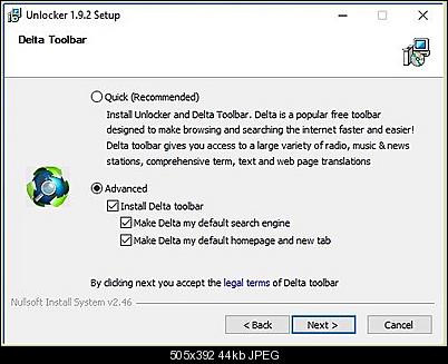

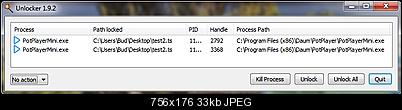

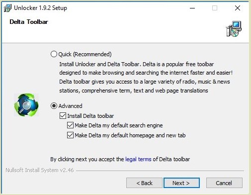

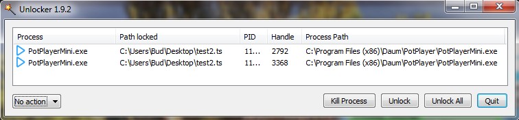

    I've used an old utility called 'unlocker'. It will not only tell what is locking it but unlock it as well. I have used it through Windows 7 but have not tested it in 8 or 10. There are several versions out there but I use the 1,9.2 version http://www.majorgeeks.com/files/details/unlocker.html and have no problems. It's also handy for deleting hard to delete/move/copy files
Name:	ScreenHunter_210 Feb. 11 23.31.jpg
    Just be sure to uncheck all the boxes as mentioned in the comments and there is no adware.
Name:	ScreenHunter_210 Feb. 11 23.38.jpg
