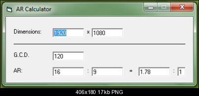

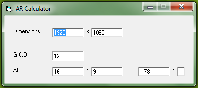

    For those of you who want to know what's the AR expressed as a reduced fraction, I prepared a small program that calculates the GCD (greatest common divisor) of the video dimensions and then divides both dimensions by that amount. Just enter the dimensions and the program does the rest.

  7. Originally Posted by Keyser View Post
    Thanks.
