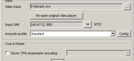

  5. How do you convert numbers to the smallest possible fraction? I've never known.
    ie How do you convert an aspect ratio of 2.76:1 to a fraction smaller than 267:100, assuming it's possible?

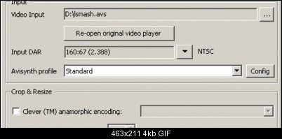

    When creating a custom aspect ratio in MeGUI, either fractions or numbers can be entered, but when the custom aspect ratio is saved, MeGUI displays both. I wouldn't mind knowing how to convert decimal numbers to the smallest possible fraction myself.
    For example, I know an aspect ratio of 2.172 is 215/99 because I started with 215/99, entered it into MeGUI, and out came an aspect ratio of 2.172. Of course I could have divided 215 by 99 with a calculator, but if I started with 2.172 I could easily convert that to 2172/1000, but how to get it down to 215/99 from there? It's probably simple enough that I'll feel silly, but I asked Google and couldn't find the answer.
    PS. For the record, 215/99 is actually 2.171717171717171717171717............. but for reasons only known to whoever added the feature to the program, MeGUI displays custom aspect ratios rounded to three decimal places. The permanent DVD aspect ratios are allowed 6 decimal places, and it's not as though there's a lack of space.

    Your link doesn't seem to work, but it doesn't matter. I hadn't thought about the infinite decimal place problem until I write my previous post, but I understand why converting 1.33333 to 4:3 mightn't always happen. Cheers.

    If you just use decimal point transferring a fraction into a number with decimal point, creating an error with decimal point, there is no way back to be exact again.
    Most aspect ratios aren't like that though, because they have a finite number of decimal places. It's only the industry standard 4:3 and 16:9 etc.
    I've always thought 16:9 was a little dumb anyway. 2:1 would have been better, IMO.
    I know this because I created a 2.35:1 custom aspect ratio in MeGUI and 47/20 came out, so 2.35 is exactly 235/100, which is exactly 47/20, which is exactly 2.35.
    Even though it rounds to three decimal places when displaying a custom aspect ratio, MeGUI seems to convert and/or save them accurately up to six decimal places. That's something I haven't complained about in the doom9 MeGUI thread yet, and I haven't had a good complain since yesterday. Programs should never tell you they're doing one thing when they're really doing something else, and for me displaying different aspect ratio rounding in the GUI to the rounding actually being used is an example of that.
    I would not let MeGui doing stuff like that, it needs for some Avisynth calculations right? Just setting proper modes (cropping) you can Resize and autocrop at the same time even using batch scripts, if not doing it quickly in the head. Just remember resizing first (same ratio as original, for example 1980x1080 to 1280 and calculating 720), then autocroping, that is the principle, this proper sequence makes a hell of a difference. Doing it other way brings you this AR nonsense calculations, maybe Megui programmer fell for it. Try it. Talking here about non anamorphic videos.
    You do it backwards to the rest of the world. The reason for cropping first is if you want to resize (for example) 1920x1080 to 1280 by something, the something is easy enough to work out, but when if you need to crop, but still want 1280 by something. Do you resize, crop and resize again. That's the main reason for cropping fist.
    The secondary reason is the resizers include all the pixels when doing their thing. If you have a single line of black down one side, it won't have the potential to effect several lines while resizing, because it's not there any more.

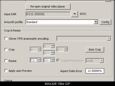

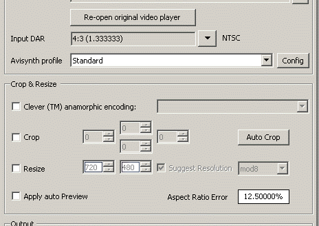

    The aspect error calculator built into the script creator was my idea. A few years ago, MeGUI would only resize for encoding in the dark ages. Everything was mod16. So I'd work it all out using the Yoda Resize Calculator quite a bit, then adjust the resizing manually to something that wasn't mod16 if need be. After convincing Zathor to drag the resizing into the 21st century, he agreed to make the script creator Yoda-like. Which by the way calculates the same way as MeGUI and everyone else. Crop first, resize what's left. It's easier if you want to choose the final resolution (width or height).
    The aspect error calculations still apply either way. If the source was 1916x1074, resizing to 1280x720 would produce a small aspect error. Resizing to 1280x718 would be more accurate, but I want 1280x720. So I change the resizing to 1280x720 and crop a few pixels from each side until the aspect error displayed is down to almost nothing. How would you get to 1280x720? Or would you just resize and not worry about the aspect error?
    I rarely use anamorphic encoding myself but if the Input aspect ratio is wrong, so will everything else. The resizing aspect error calculation are based on the input aspect ratio for anamorphic sources. When anamorphic encoding is enabled, the script creator shows everything as a display aspect ratio. That's more intuitive than using PARs. The aspect ratio added to the top of an anamorphic script is calculated from the Input Display Aspect ratio, then taking any cropping and resizing into account. Finally, you add the job to the queue and MeGUI uses the display aspect ratio at the top of the script, along with the scripts output resolution to calculate the PAR it needs to add to the x264 command line. When I was using anamorphic encoding myself, that always worked as it should. There's an option in the AVisynth profile configuration to tell how much aspect ratio fudging is permissible for anamorphic encoding. You can change it to none (0%). MeGUI gave me a couple of unexpected aspect ratios a long time ago. Eventually I discovered you can't change the resizing in a script after it's been put in the job queue. All the checking has been done by then and for some reason MeGUI will try to correct the changed aspect ratio by adjusting the pixel aspect ratio. Even for non-anamorphic encoding. So I learned my lesson. If you change the resizing, delete the script from the queue and reload it.
    Sometime the aspect of the source is wrong. I find it easier to correct that by adjusting the Input Display Aspect ratio. That way the resizing and aspect error calculations work correctly. For instance if you crop and resize a 4:3 DVD but set the input aspect ratio to 16:9, MeGUI obligingly assumes it's 16:9 and calculates from there.
    MeGUI doesn't always get it right. If a source has a DVD resolution and it's fairly close to 4:3 or 16:9, it just uses 4:3 or 16:9. I'm too OCD about aspect ratio not to correct it. Here's an example:

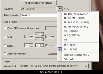

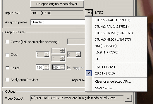

    MeGUI uses retarded ITU aspect ratios for DVD calculations. They're retarded because they're the least accurate, I think MeGUI is the only currently maintained GUI using them, and if you encode for Bluray compatibility, the ITU aspect ratios used by the script creator have to be adjusted to mpeg4 aspect ratios for encoding. I've gone on about a few times in the MeGUI thead at doom9. Surprisingly, the only response has been to tell me I'm wrong because it doesn't matter. I'm not. The mpeg4 aspect ratios are closer to the real ITU aspect ratios than the ITU aspect ratios used by MeGUI, if the script creator used them they wouldn't need fiddling with for Bluray, and they'd be the same as the aspect ratios you can set in the x264 encoder configuration. And there's another nice little side effect. If you use the mpeg4 pixel aspect ratios, you only need two custom display aspect ratios. PAL 4:3 and NTSC 4:3 have the same display aspect ratio, as does 16:9. and the two display aspect ratios are so easy to remember even I can do it. 20:11 and 15:9. Can you recite the ITU aspect ratios without checking?
    If I create custom aspect ratios for no other reason, it's at least to use mpeg4 aspect ratios for DVDs rather than retarded ITU, assuming I'm not using the generic PARs. Unfortunately though, deleting custom aspect ratios is an all or nothing deal, which is a bit annoying. I've mentioned that a few times, but I think I'll return to harping on about an anamorphic encoding option called "encode non mod16" even though it's perfectly capable of encoding mod16.

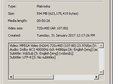

    I have a 720x480 source with a 107:80 aspect ratio. I wasn't guessing. MeGUI assumed it was 4:3 because it's 720x480. I wanted to use the aspect ratio written to the video instead. It was a simple point. Of course there's a chance the aspect ratio could have been set wrong after cropping or residing but there's no way to know, and it's more likely it was correct.

    MeGUI doesn't guess the aspect ratio. It uses the aspect ratio for the same reason a player does. The only exception I've found is when the resolution happens to be exactly 720x576 or exactly 720x480. I assume somebody decided that was a good idea. Fortunately, you can create custom aspect ratios in order to use the aspect ratio written to the video stream instead, but for everything else there's no need.
    For the record the above video is 1280x536 worth of square pixels.
    1280/536 = 2.3880597014925373134328358208955
    and.....
    160/67 = 2.3880597014925373134328358208955
