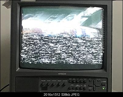

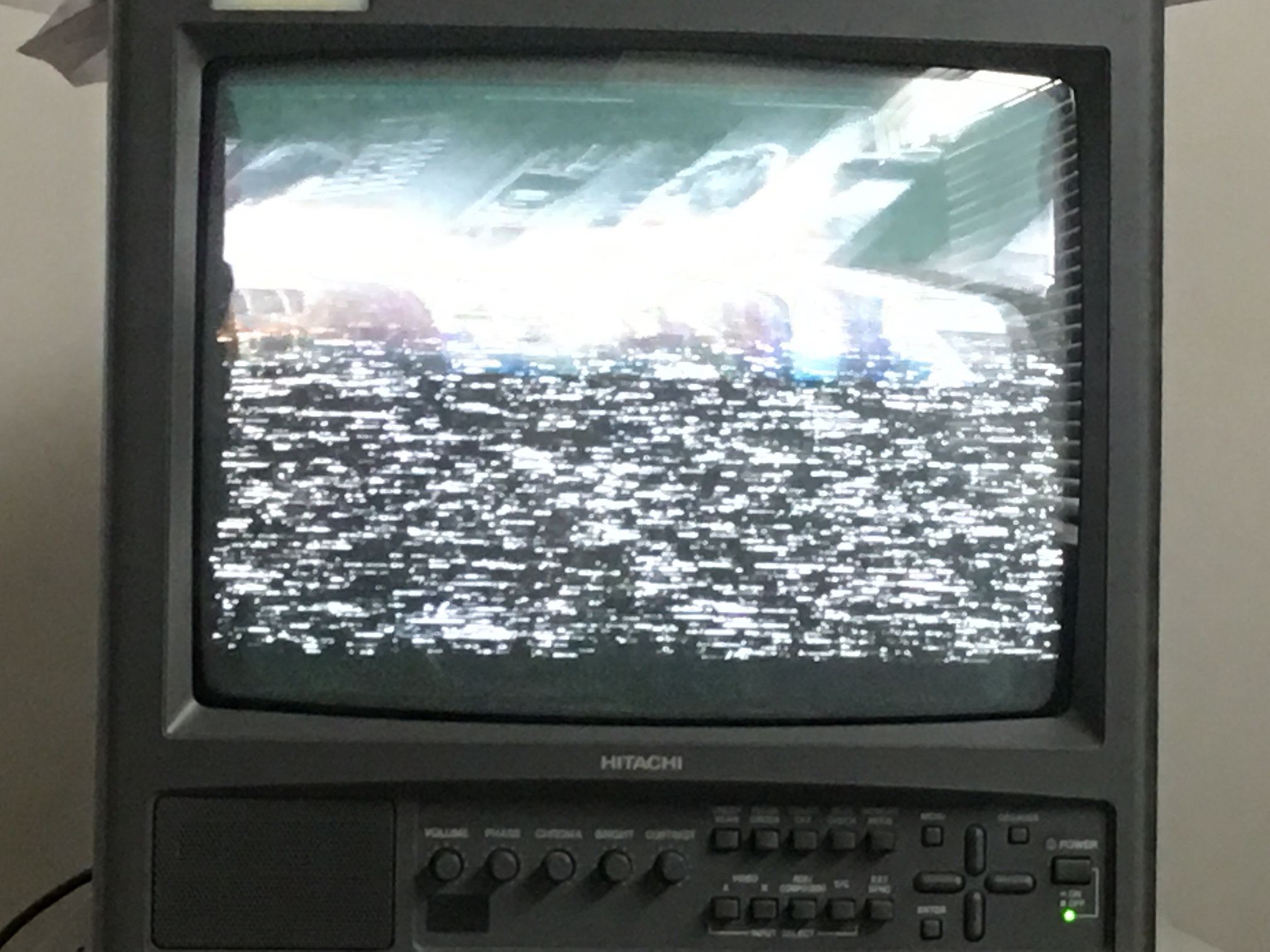

  1. I have a Panasonic NV-HD620AM VCR. Both PAL and NTSC tapes recorded in SP play back perfectly. When I put in a PAL tape recorded in LP or an NTSC tape recorded in EP, the tape will not play back cleanly. The VCR will not lock sync and I get an image that looks like this...see attachmentClick image for larger version
ID:	40493 You can kind of see the image through all the hash so I know it is playing back, just not in any viewable form.
    I've tried cleaning the heads with Alcohol and microfiber cloth...but that doesn't seem to fix it.
    Are the LP/EP heads just shot?

  3. Originally Posted by JVRaines View Post
    Do not clean video heads with fibrous material. If you catch a loop on a head, you can easily break it off.
    I assume you have tried the manual tracking control?
    It's definitely not a tracking issue, the sync is so unstable I can't even use the pulse cross on the monitor to check the VBI.

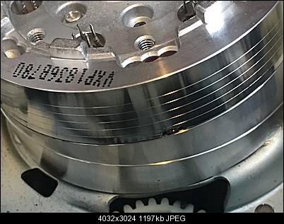

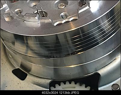

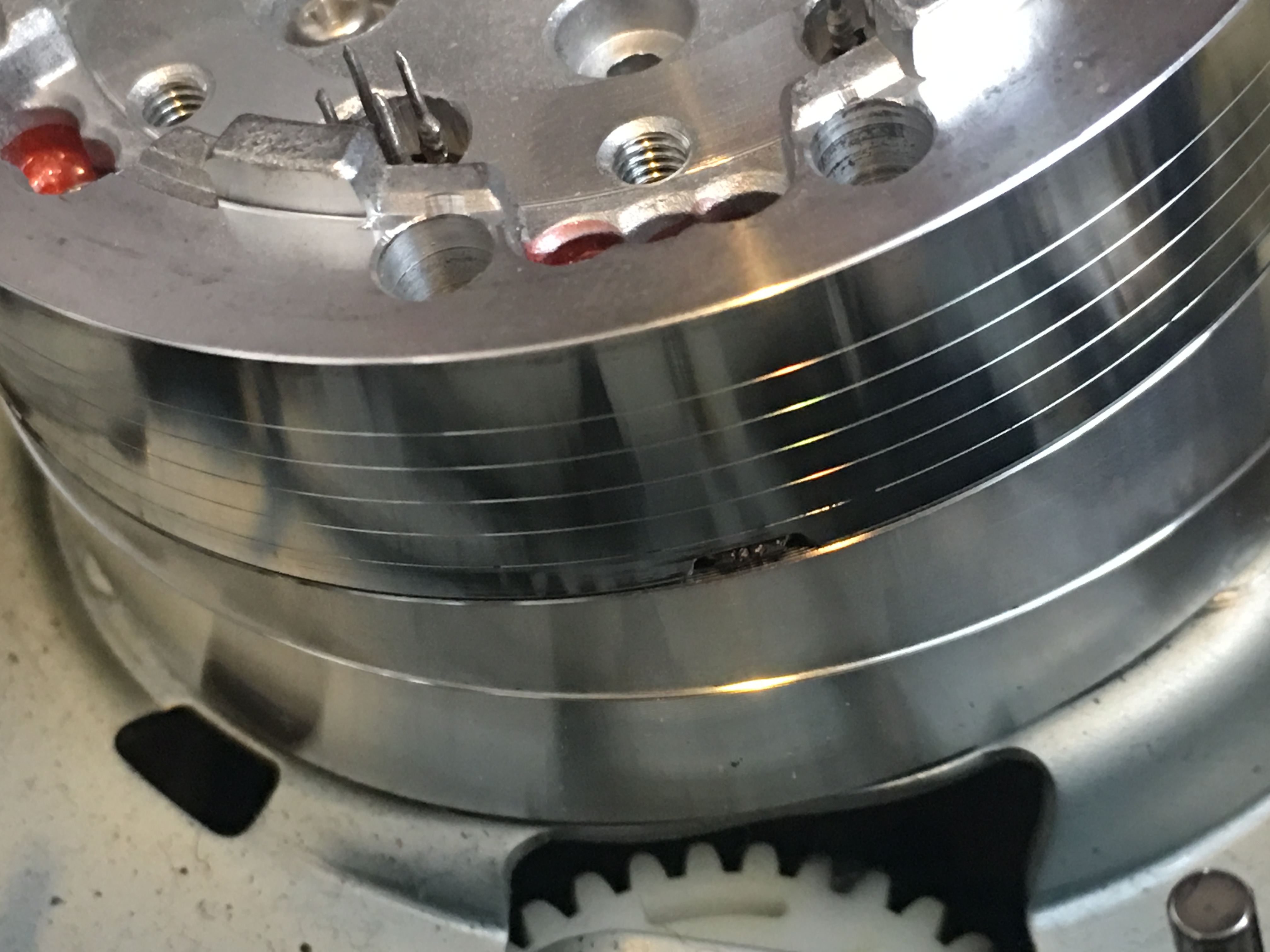

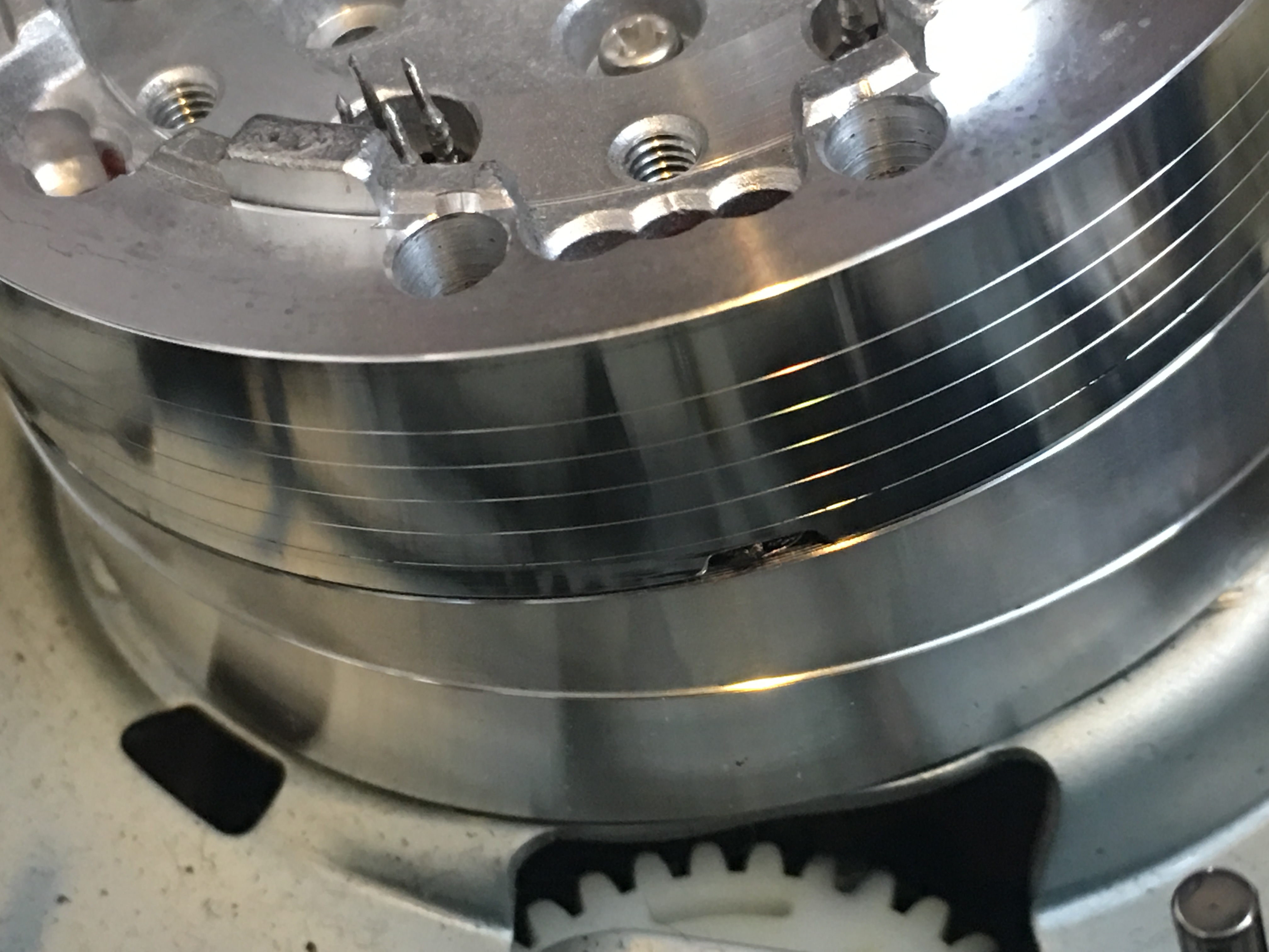

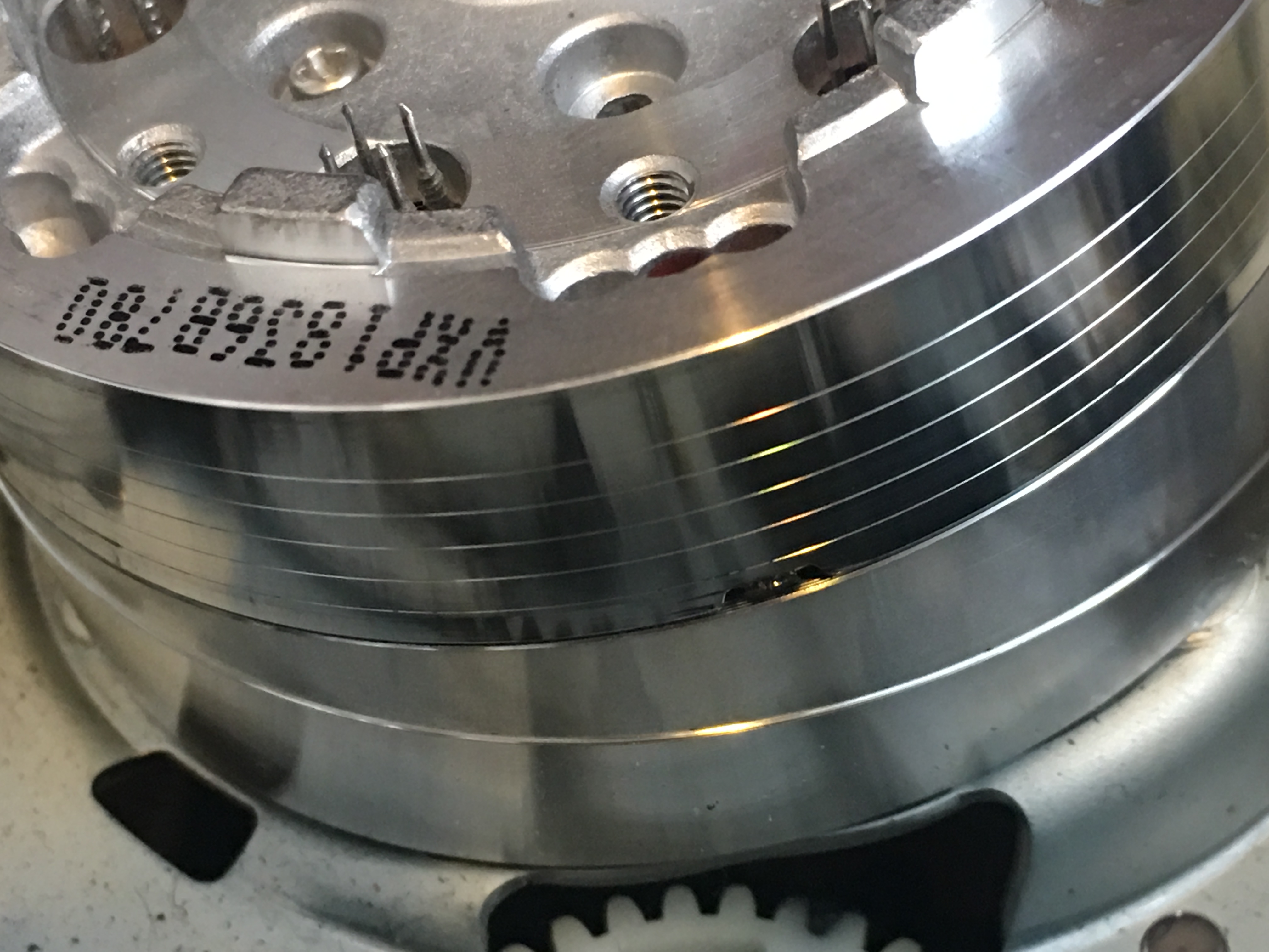

  8. I've taken a picture of each head and attached them, some do look like they have some black streak before the head...I've tried cleaning them numerous times with 99% isopropyl alcohol but nothing seems to clear it up.
    Do they look damaged?

    Aug 2010
    San Francisco, California
    You really need to take the deck to a technician who can inspect it in person. If the problem were dirty heads, you would get no picture at all, not half a picture. Most likely it's a tracking issue.

  16. So I had a technician look at the VCR. He checked all the heads under magnification and came to the conclusion that one of the heads was damaged. He said he could see a damaged coil. So I guess it was of the heads that is needed for LP/EP playback since SP playback is still completely fine. So I probably don't really have any more options, unless someone knows where I may be able to find a replacement head for this VCR!
    Guess I will have to search for a new PAL VCR.
