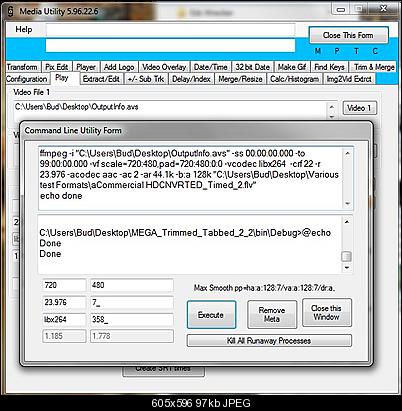

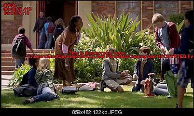

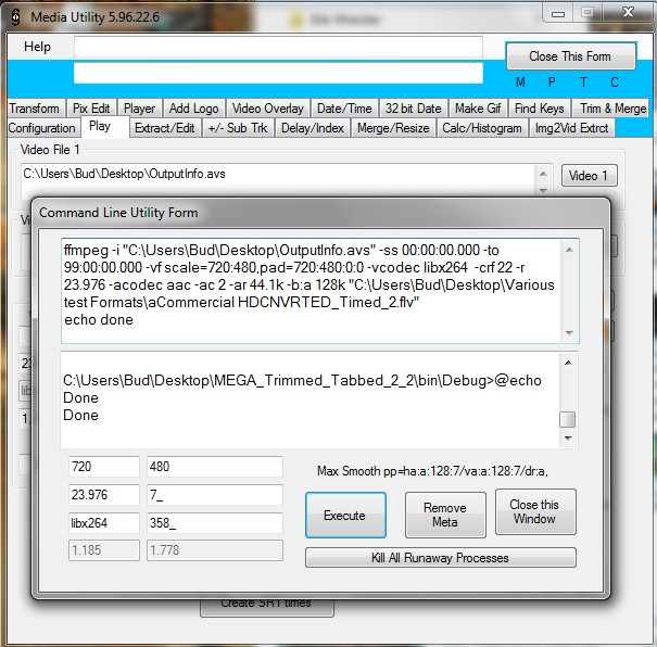

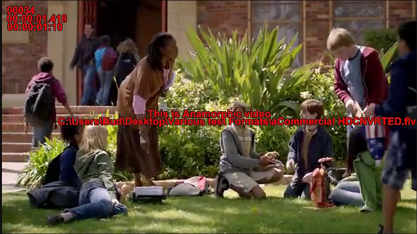

    You can use ffmpeg and avisynth to easily add the extra information. In the example below Frame number, time codes and other information is included in the avisynth script. Then just use this as your input to ffmpeg and it will encode it into your video.
    AVISYNTH script:
    DirectShowSource(("C:\Users\Bud\Desktop\Various test Formats\aCommercial HDCNVRTED.flv"), Pixel_Type="yuy2").Crop(0,0,-0,-0)
    LanczosResize(854,480)
    Subtitle("C:\Users\Bud\Desktop\Various test Formats\aCommercial HDCNVRTED.flv", x=853, y=260, font="Arial", size=24, text_color=$ff0000, align=3)
    Subtitle("This is Anamorphic video", font="Arial", size=24, text_color=$ff0000, align=5)
    ShowFrameNumber(scroll=true, x=10, y=27, font="Arial", size=24, text_color=$ff0000)
    ShowTime(x=72, y=44, font="Arial", size=24, text_color=$ff0000)
    ShowSMPTE(fps=23.976, x=68, y=61, font="Arial", size=24, text_color=$ff0000)
Name:	ScreenHunter_210 Feb. 08 23.22.jpg

Name:	frame codes.jpg
