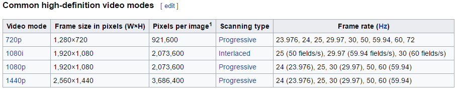

  30. Member awgie's Avatar
    Sep 2008
    Lanarkshire, Scotland
    pandy, I must respectfully disagree with you.
    Do or do not. There is no "try." - Yoda
