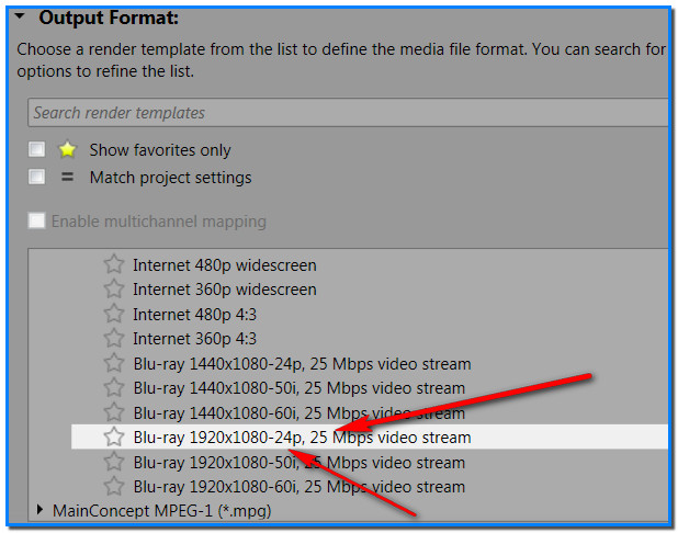

  12. You export 24p? In first input of yours you explained exporting 25P.
    Exporting 25p, you need to select 1920x180, 50i (sometimes marked as 25i, do not get confused, it is the same thing) Blu-Ray stream, and then fix it in settings, clicking custom button, then changing interlace to none. This way you change 50i to 25p.
  13. Originally Posted by _Al_ View Post

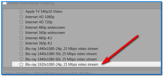

    Sorry for delay getting back to you. I got confused between the 24 fps and the 25 mbps. I rendered as per the attached. By export you mean render as in file/render as?
    I do not understand why it should be 1920x180, 50i when i want it progressive? Isn't that p and wher eis settings/custome button. Thanks

  14. yes, in Vegas if you export you go File/Render AS ...
    Export templates in Vegas are a mere suggestions, lots of those values could be changed, perhaps not all of them but almost all of them. Lots of folks is coming to Vegas from Pinnacle or Premiere and overthere (Pinnacle I do not know guessing here) export templates are pretty set with parameters. So in Vegas you choose that template 1920x1080 50i , simply because there is no 1920x25p Blu-Ray template , because that is no Blu-Ray spec 25p. Blu-Ray could be 1920x1080 and 50i only. So you choose that template , click CUSTOM and change interlace to NONE, maybe it is marked as field order there, not sure now. Choose bitrates, 2pass VBR most likely with average bitrate, if you enter for example: 11,000,000 that would mean 11Mbit/s. Vegas wants those numbers in millions, 1 million means 1Mbit/s = 1000kbps
    But you can choose another template, not just MainConcept mpeg4/avc, even that Sony avc and do the same, pick up some closest template, like some internet stream and then in CUSTOM changing parameters to 1920x1080 25 progressive (that means field order is NONE). Make sure profile is set to HIGH, sometimes if not setting it HIGH you cannot change other parameters like fullHD resolution, not sure now, maybe I was using older version but today it is fixed or it is , sort of, a "security" feature not sure, to not set profile main for fullHD, don't know.
