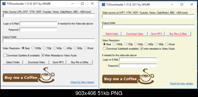

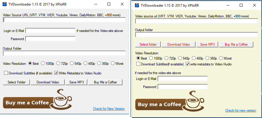

    excellent program, I was going to say if I could modify it but I do not know how to say it modify the tool that was created in the temp folder with the notepad save the ffmpeg, ffprobe and the tool to uninstall it and have it portable youtube-dl already had it in the sm player.
    I use a translator to write in English because I do not think they accept Spanish
