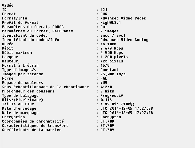

  4. I got the 2 files one for the video (1.32gb) and one for the audio (33mb) but the problem now is that they are encrypted!
    [Attachment 61126 - Click to enlarge]
    I saw that there was the mp4decrypt software, should I use it? I do not know how to use it I saw some commands on the forum and I got a key with Widevine Guesser but I do not know how to implement?

  5. Originally Posted by STRiCK3R View Post
    PS: Sorry for my English unfortunately there is Google ^^
    run cmd in the same folder where mp4decrypt is
    mp4decrypt --key keyID:key vid.mp4 vid_dec.mp4
    you should change keyID:key to actual keyID and key and vid.mp4 to the name of your video file.
    vid_dec.mp4 will be created and it will be the decrypted video.
  6. Ok I think I understand how it works but I can't find the mp4decrypt software can you share it with me please?
    I would need more precision on the KeyID and on the Key how to differentiate the 2 and where to find them?
    Widevine Guesser found me this key "aa8be47a53e629b0e0533b28450a1cbb: a8f3e30c8fc28072e8545cda37a997d7" is this the KeyID or the Key?
    You have already helped me, it's nice
  7. first is keyID, second is key.
    anyway use as mp4decrypt --key aa8be47.....:a8f3e30.... <input.mp4> <output.mp4>
  8. Great it worked
    I have assembled the video track and the audio track with MKVToolNix everything is functional.
    Thank you for your support and for your time spent helping us so kindly

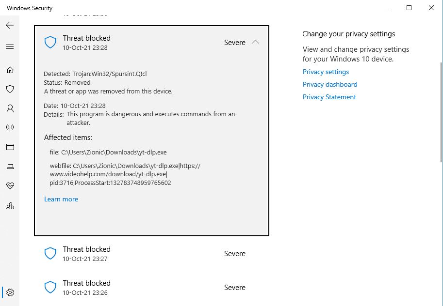

    Latest version of yt-dlp contains a virus, impossible to download under Windows 10.

  15. Originally Posted by Penthe View Post
    [Attachment 61236 - Click to enlarge]
    1. It's not a virus, it's a false positive. - https://www.virustotal.com/gui/file/5124fc9b2b690bb16d913c606a97f7da6ad376a48656e7ccb6...f2b6/detection
    2. Very possible to download when you turn off real time protection and cloud based protection.
    Yes and then it got deleted again when you turn it back on, it´s not helping.

    By using another browser then Chrome and disabling real time and cloud based protection the download went well. Thanks for your support!

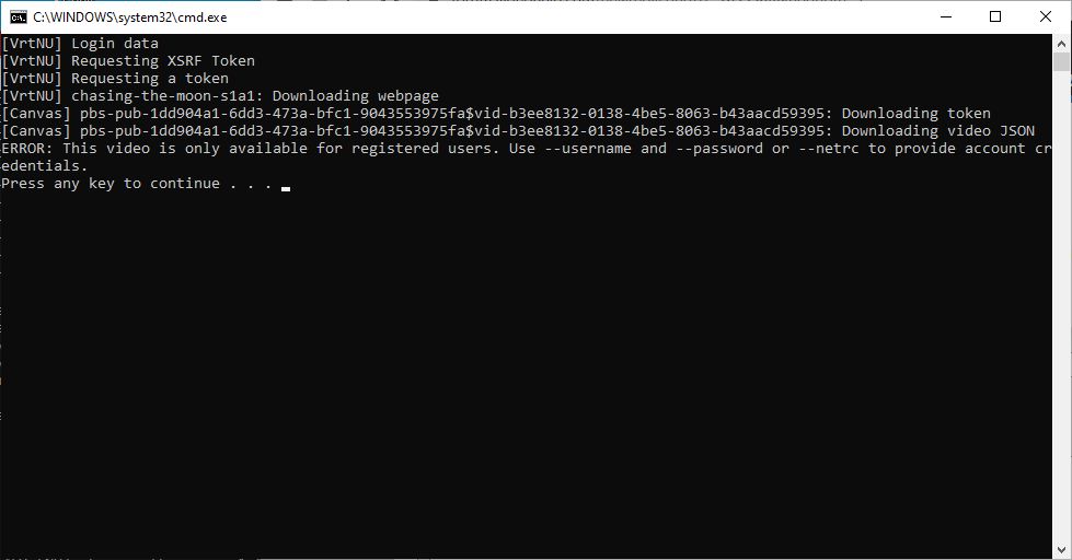

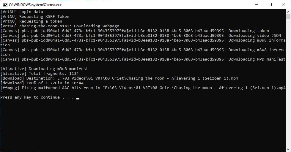

    New error on vrt.nu:
    [Attachment 61626 - Click to enlarge]
    Yesterday, everything went fine (same link):
    [Attachment 61627 - Click to enlarge]
    Thanks for taking care!

  22. Originally Posted by jschrooyen View Post
    Got the same problem. Streamdetector isn't working anymore for this program.
    I have another program that can download from VRTnu without any problem.

    you have put username and password ??
    seems to be the problem ...
    if not, write here video link.
    Thanks for your support, lomero, but yes, everything was exactly the same as yesterday. The video link was included in my post (discretely hidden under the word "link", where you would never expect it), but the issue is the same for every link in this domain.
    I am curious about the workaround that Zwartgallig_ has up his sleeve, however.
    Cheers!

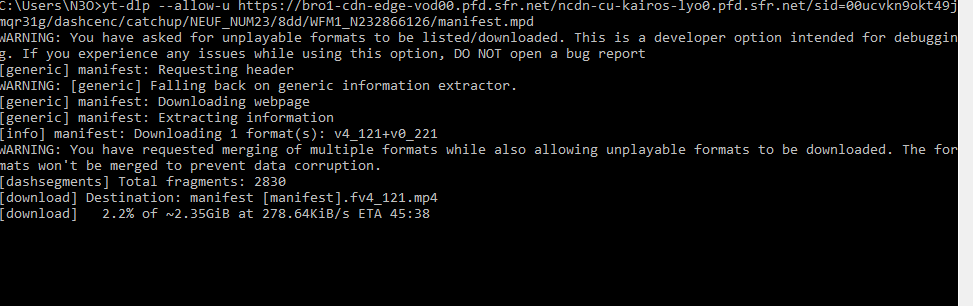

  24. content encrypted.
    need key
    f9fccb7f2fd11102716c37315b77b8ed:86e0291a83fcecbbbeccacd806a32893
    download with yt-dlp
    yt-dlp --allow-u https://remix-cf.lwc.vrtcdn.be/remix/e9c0dd43-0bd5-4d6b-8f3f-e77d622d4268/remix.ism/.mpd
    @ Zwartgallig
    i don't think you have another app that does this ...
    this content is encrypted. there are not many apps that allow you to download this video ...
  25. It doesnt need the key there is a drm free m3u8 url example >> url https://remix-cf.lwc.vrtcdn.be/remix/e9c0dd43-0bd5-4d6b-8f3f-e77d622d4268/remix_aes.ism/.m3u8 its just that the yt-dl//yt-dlp vrt nu extractor broke because the vrt changed something so only option for now is to look for the mpd url and change the end of the mpd link to remix_aes.ism/.m3u8 to download no key needed or use https://downloadgemist.nl/ or gemistdownloader and in the mean time you can open a new issue on yt-dlp for the broken vrt nu extractor
