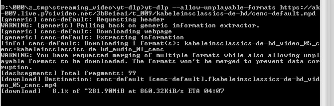

    upload to latest version. a big update is available today
    then:
    yt-dlp --allow-unplayable-formats https://ak-009.live.p7s1video.net/3b8e1ea1/t_009/kabeleinsclassics-de-hd/cenc-default.mpd
    [Attachment 60150 - Click to enlarge]

  4. Thank you, yes: But this is a never ending live stream of a tv channel. The above 281 MB are only a few minutes. The Default-MPD is updated every few seconds. Is there a tool for downloading such live streams?

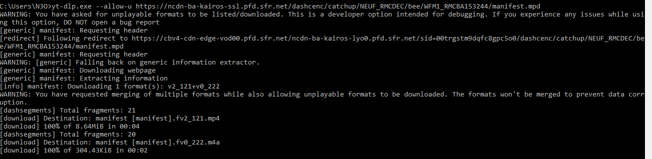

  25. Yes, that's it, he only downloads 30 seconds of the video. I obtained this mpd while being logged into the site. I will try what you advise me thank you
  26. I tried with yt-dlp but it downloads the same thing to me only 38 seconds
    [Attachment 61112 - Click to enlarge]

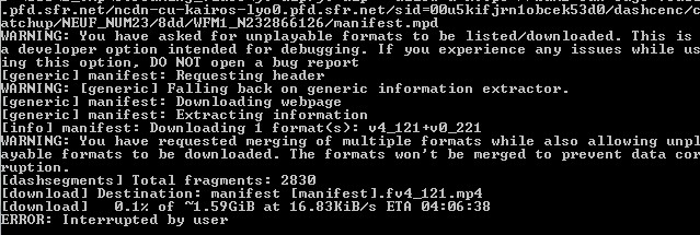

  29. full video 1.59GB
    yt-dlp --allow-u https://bdx1-cdn-edge-vod00.pfd.sfr.net/ncdn-cu-kairos-lyo0.pfd.sfr.net/sid=00u5kifjrn1obcek53d0/dashcenc/catchup/NEUF_NUM23/8dd/WFM1_N232866126/manifest.mpd
    [Attachment 61114 - Click to enlarge]
