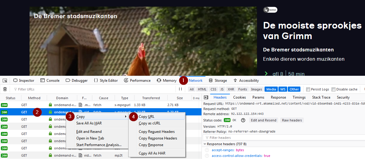

  9. Hi,
    I haven't read the whole thread so I don't know if this solution has already been posted. If so, sorry for the double posting... .
    When you download from VRTNu and you get following error : "Invalid data found when processing input" you might still be able to download it easily. As long as it is not DRM protected of course. I do regularly get this error while it is not DRM protected.
    Example :
    1) link https://www.vrt.be/vrtnu/a-z/de-mooiste-sprookjes-van-grimm/1/de-mooiste-sprookjes-van...adsmuzikanten/ gives error "Invalid data found when processing input". At least it did when I tried.
    2) in your Firefox browser, press F12 to open the developers' options (same in Chrome I think).
    3) launch the video a few seconds and stop it.
    4) copy following URL : (see VRT NU.png screenshot, cannot get the image pasted inline here...).
    result1 : https://ondemand-vrt.akamaized.net/content/vod/vid-65ea49a8-14d1-4233-831e-5d02909ff24..._nld=1000.m3u8
    Clearly, it is not DRM protected (take the whole URL and you'll see 'nodrm' in it. If you see 'drm' instead, you will not be able to download it whatsoever.
    Change the URL by looking for ".ism/". Clear everything that is behind that part and replace it with ".mpd" :
    result2: https://ondemand-vrt.akamaized.net/content/vod/vid-65ea49a8-14d1-4233-831e-5d02909ff24...897bd.ism/.mpd
    5) Enter the URL you got in result2 into TVDownloader. Done! (no need to change settings to 'worse' or whatever).
    Enjoy!
    MataMax
